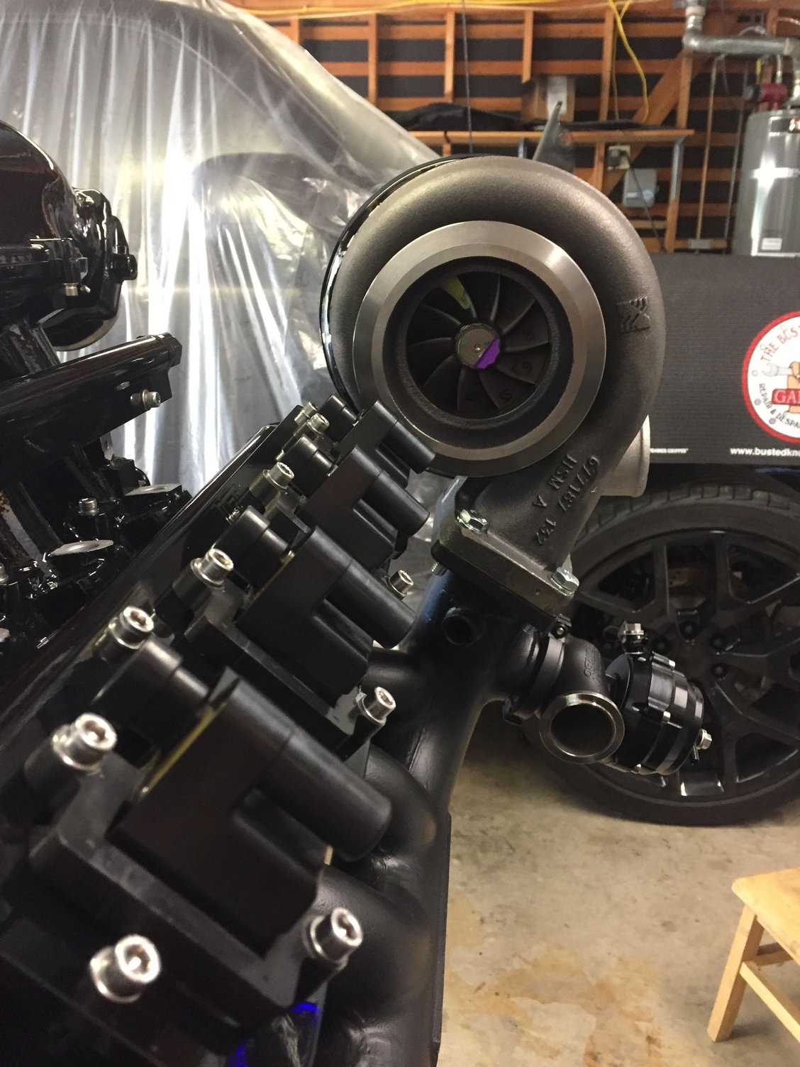

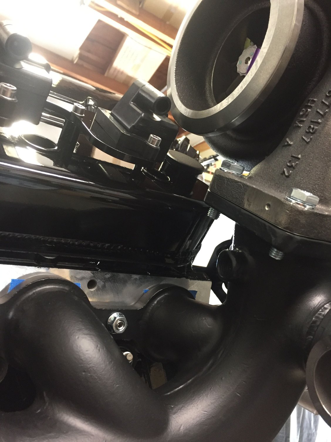

So this sucks, FYI, tall Holley sniper valve covers put the coil right in the line of fire of the exhaust housing with the Trick T6 and s480. Have to go back to the stock valve covers.
