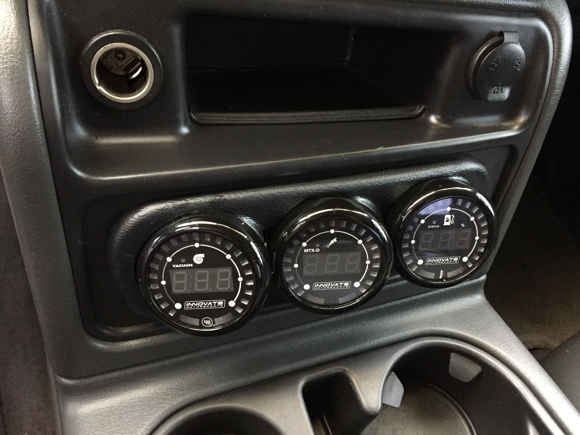

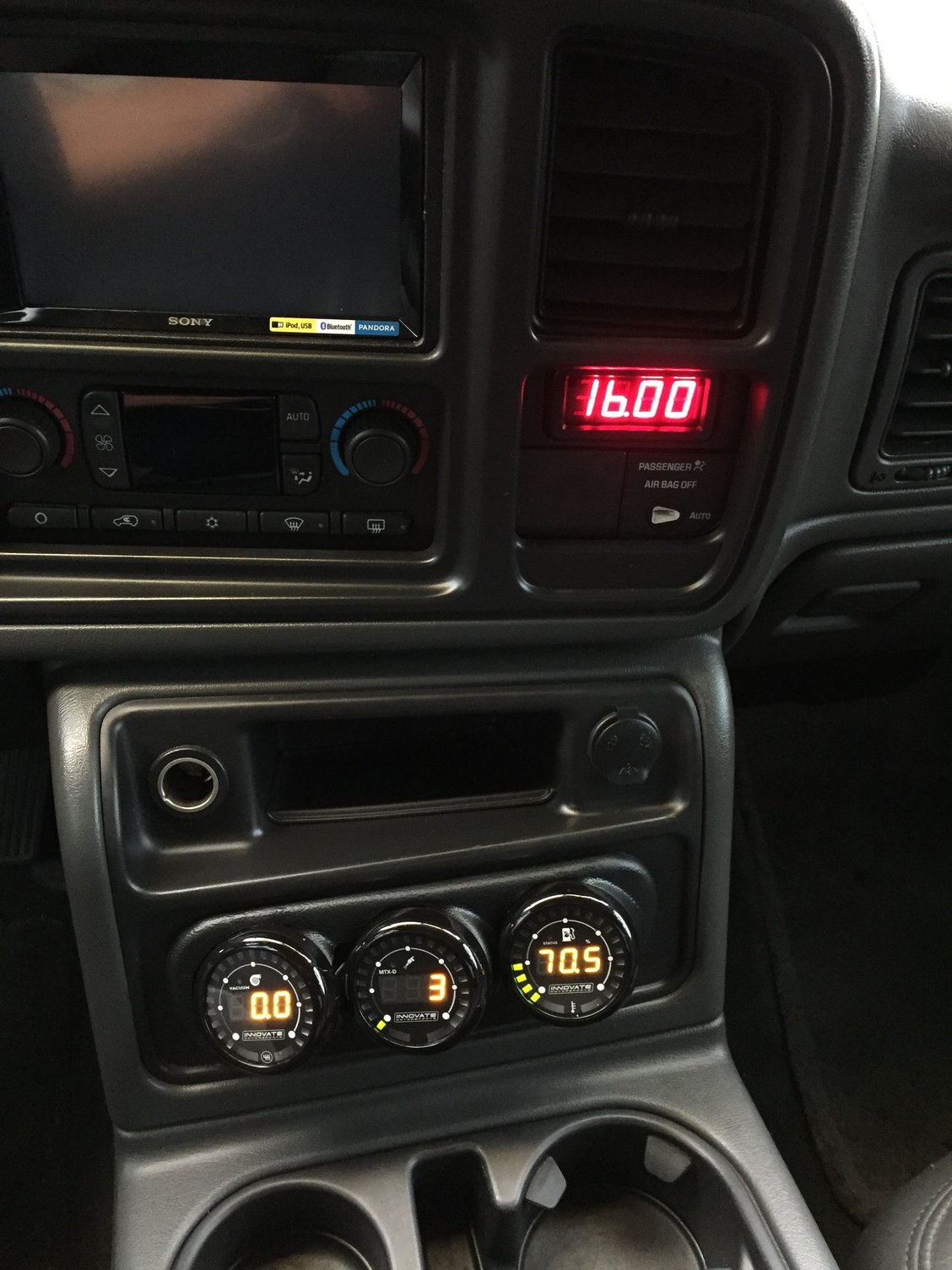

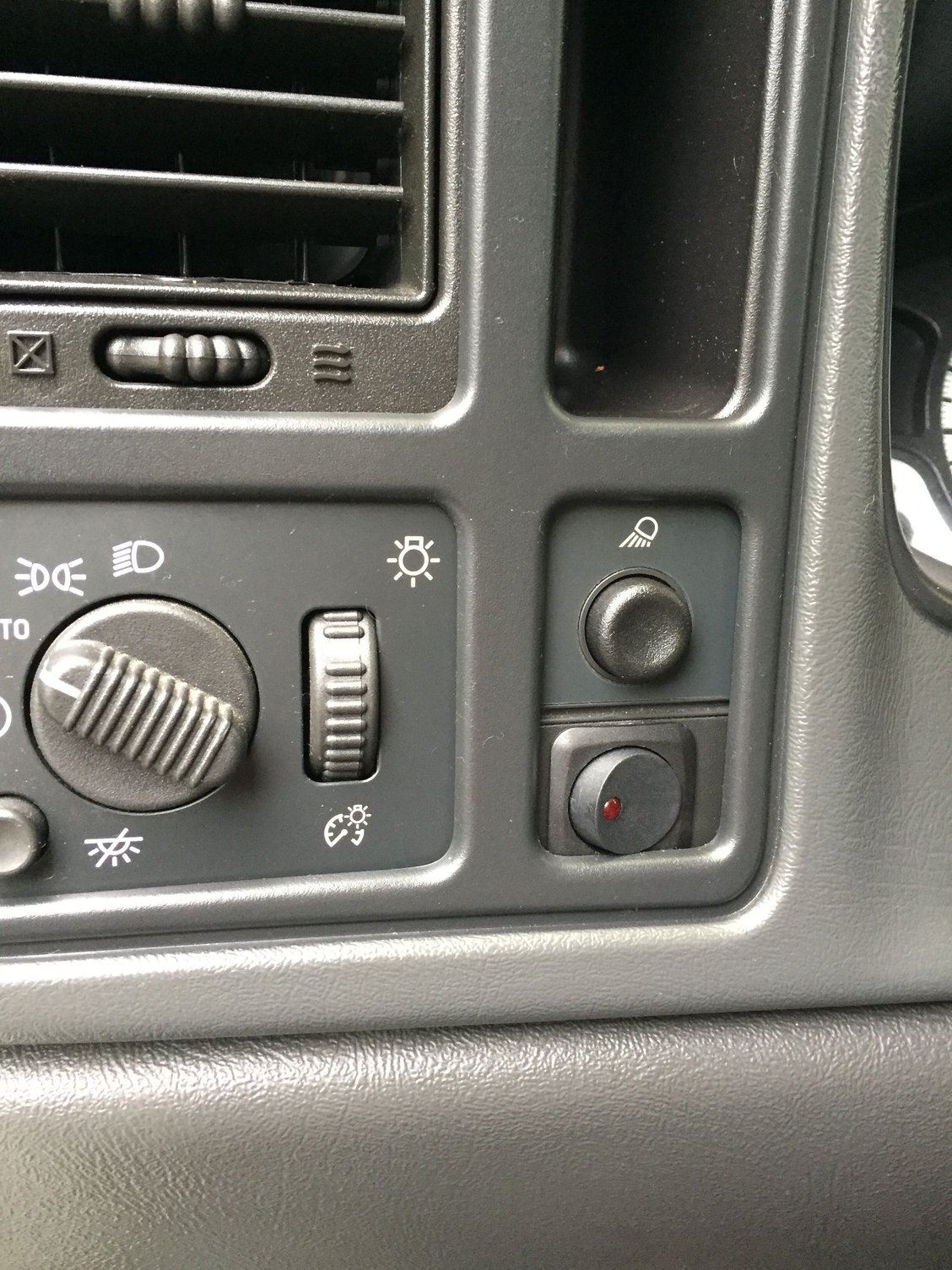

Been having some issues with tuning the Hughes 4l80 swap trans but on a positive note, I finally finished the mounting of the AFR500 wideband, boost, fuel pressure, ethanol % content and 2 step toggle switch.

Very nice! Is that center gauge fuel pressure measured in bar?

Thanks Bud, no the fuel pressure is psi. The trucks off just in accessory. Both 450 pumps don’t seem to hold line pressure once the truck is shut down. I thought the Wally’s had check valves to prevent this.
Old May 15, 2018 | 09:33 AM
  #185
Atomic's Avatar
I have a gauge for that
Posts: 16,282
Likes: 438
Mine hold pressure pretty well...sure you dont have a leak somewhere? Likely inside the fuel bucket.

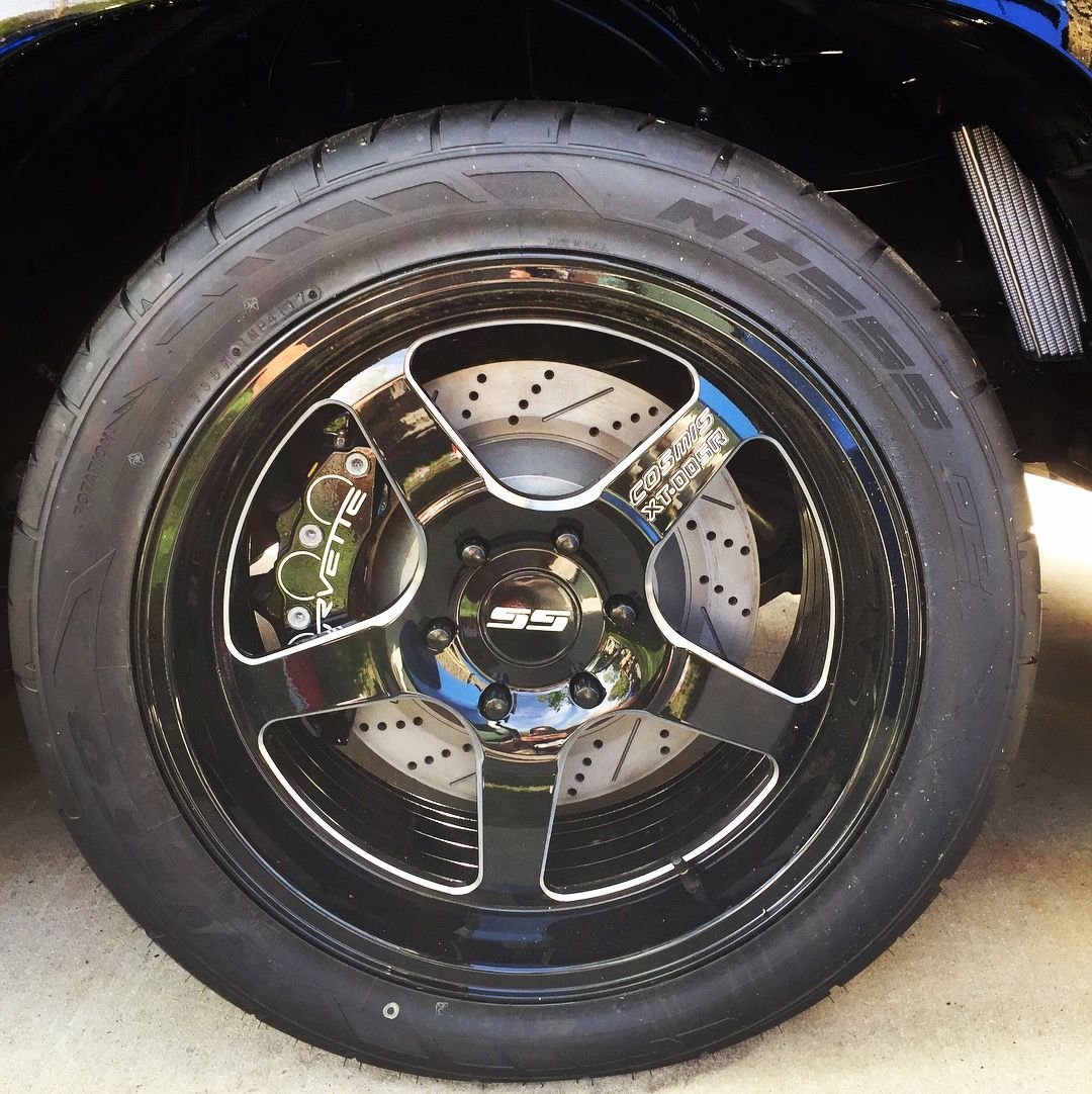

Originally Posted by SDjeff619
Got a cheap $10 set of wheel center caps and SS vinyl decals for the Cosmis wheels. I prefer a flush center cap over a giant plastic button sticking out of the center.
I also got everything in the engine compartment done. It was a little nerve racking for the initial startup with a new motor, trans, turbo, entire e85 fuel system so on and so on. Atomic supplied the start up tune but engine shuts down after 30 seconds going into REP mode with a handful of codes.
Very nice job!
