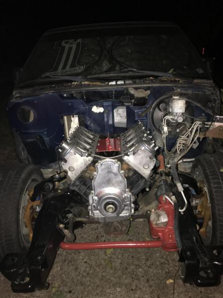

Got to test fit the motor last night. awesome fitment with no rubbing or touching!

Got my Circle D TC and trans mounted. Shoved everything into the Slonoma. Had to lift the front half of the cab up to make rooms but she’s in and all torqued down. The two are now one!
Definitely the exact opposite of throwing a hotdog down a hallway!
Good clearance
Hoping the front springs start settling a little more otherwise the 3” drop in the back is going to look goofy lol

you still have a ton of weight to add back to the front. also, roll it back and forth about 3'. it will probably settle some doing that.

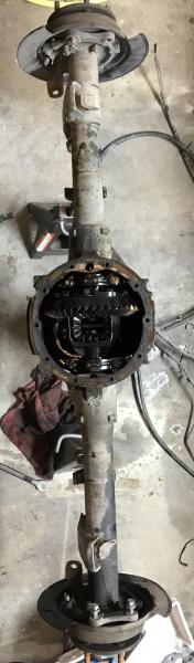

Some more updates. Got my hands on an 8.5” rear end with disc brakes! Unfortunately had open diff so getting an Eaton Posi-Trac and 3.73 ring and pinion. Did coil relocation. Ordered radiator, dual fans, new rear suspension minus leafs since I already have the ZQ8 setup. 3” blocks for the rear. Boooo... open diff with 3.42 gears...

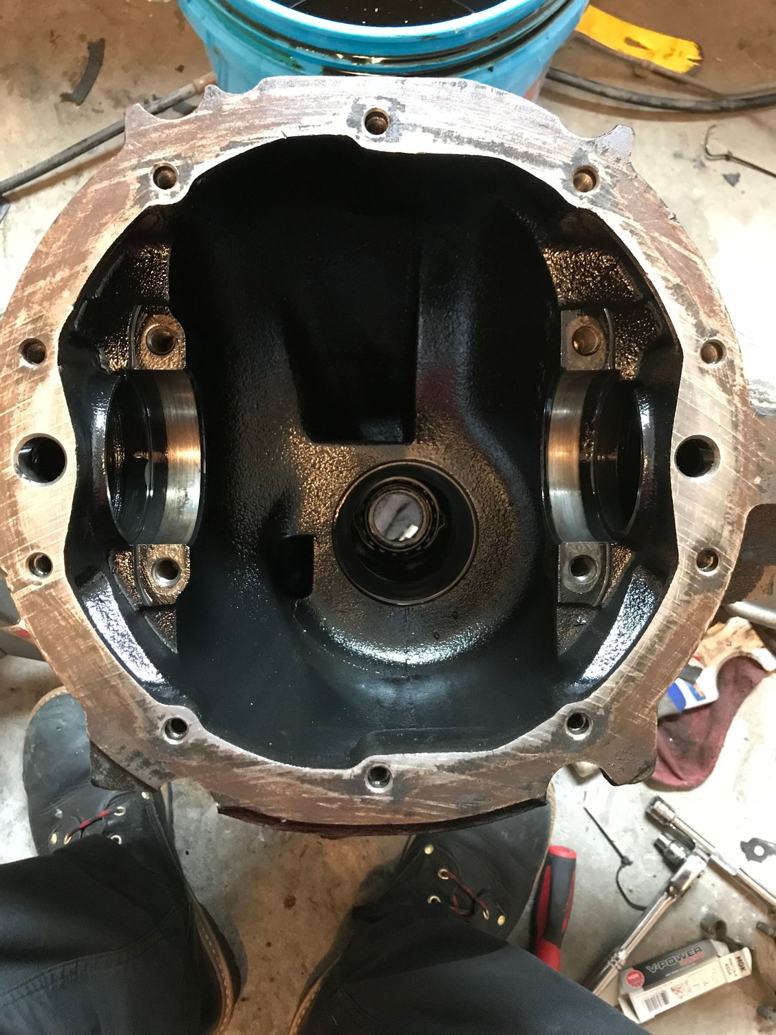

Got the box off and found 15 years of lovely Texas caliche...
All washed up
The old 7.5" out!!
Coated the frame
Got my 3.73 gears in... Just waiting on my posi diff so I can complete rear end. Swapped over the leafs and installed lowering kit and new shock absorbers. Then its putting an *** back in the Slonoma!

YUP! full blazer rear end with discs
