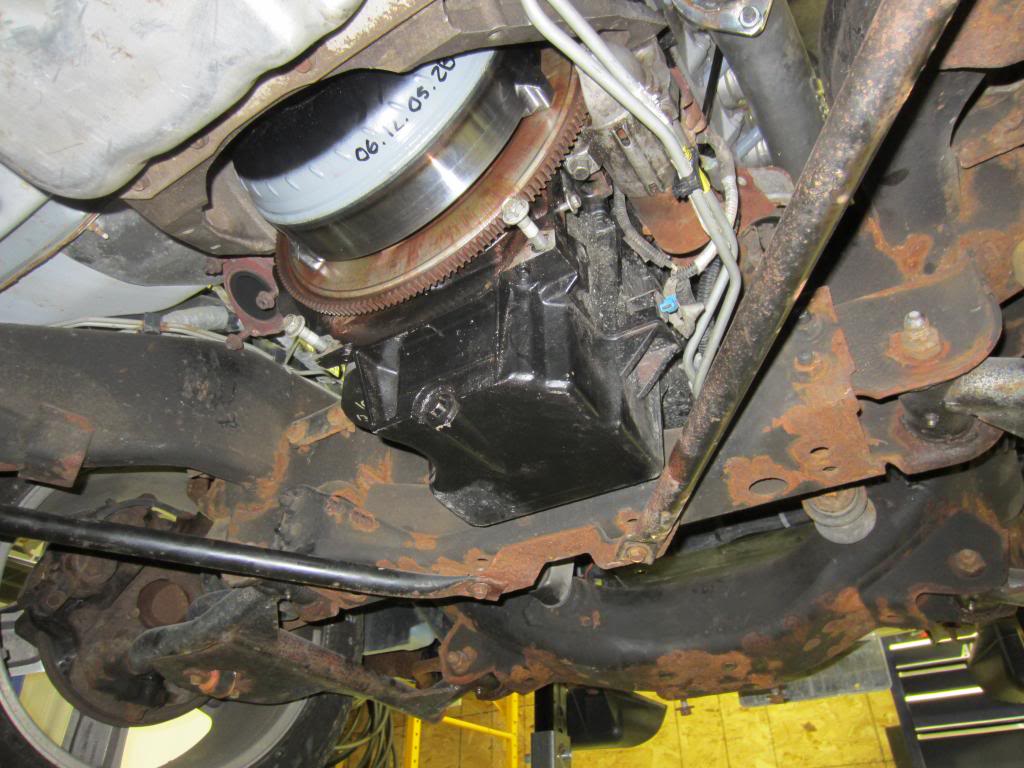

I looked at Choda's too and it's very similar in height to mine. Both should be plenty high enough, considering the distance from the top of the pan. No different than going into the side of the pan somewhere else. Here's a better picture of my location.

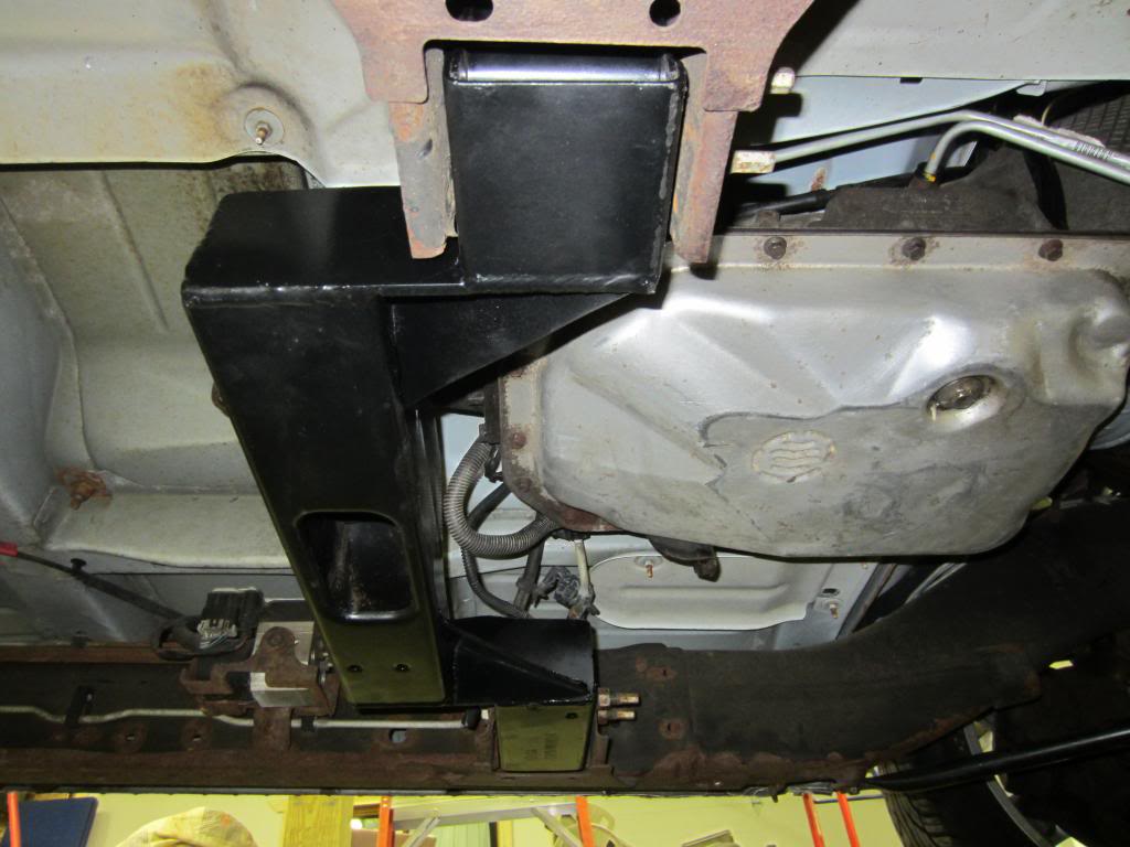

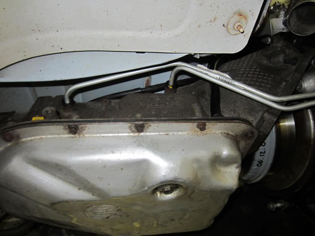

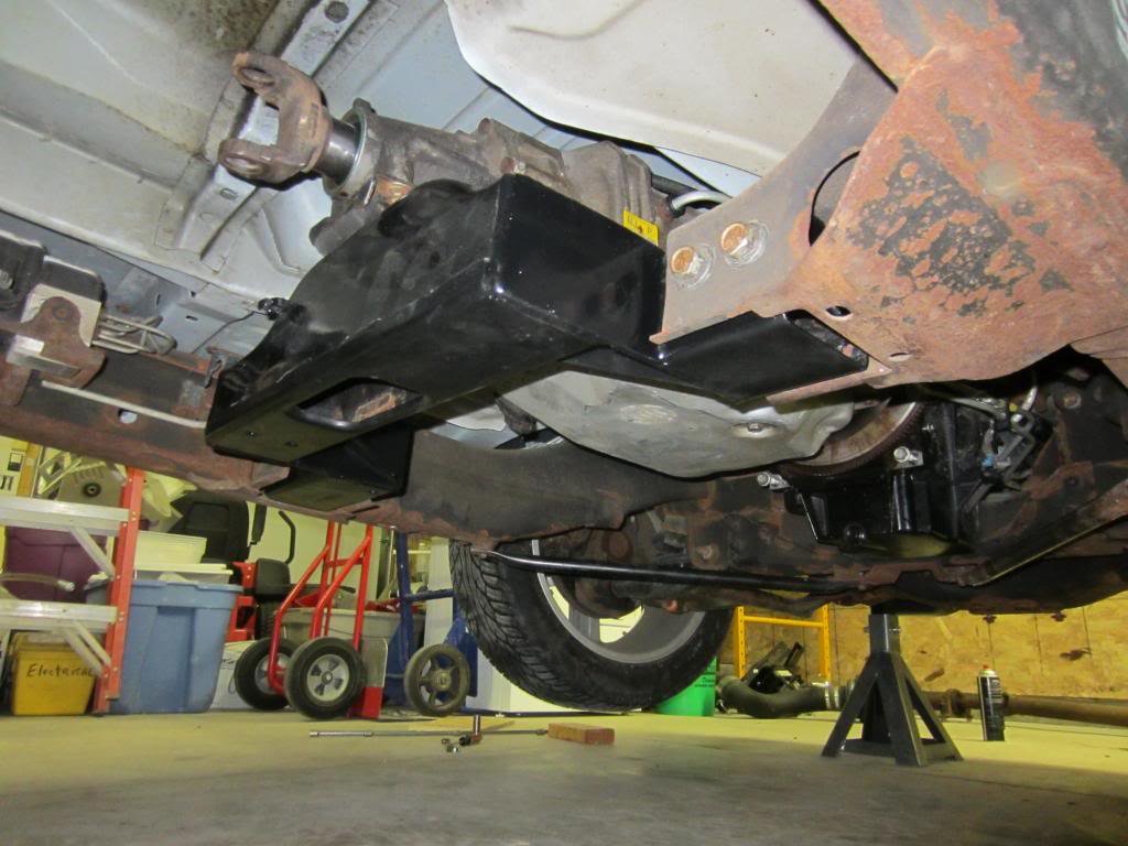

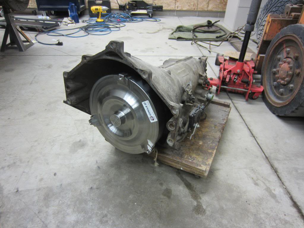

Made a big step forward yesterday and it feels good. We got the 4l80e fully installed. It went way easier than pulling the 60e, surprisingly. Everything slid right into place perfectly. Even my eyeball-measured cross member was dead on. I used factory 4l80 cooler lines rather than extending the stock one.
First pic is the old cooler lines removed. I struggled way too long before I realized it's way easier to pull them out towards the front instead of the rear, lol.

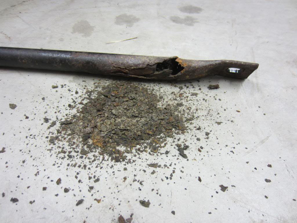

How's this look? This is the brace that goes from the frame to the engine cradle. It broke all the way in half when I tightened it back up to the frame...

Transmission in!

Starter and everything else up.

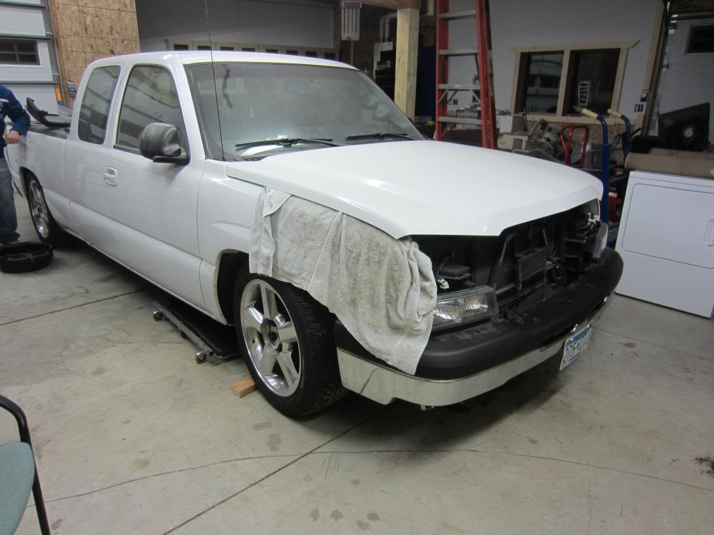

Front end pulled to run the new tranny cooler lines back. Was going to pull the bumper but the bolts are too rusty so I removed the valence instead. Now I'm wondering what will work the best for adding a tranny cooler and intercooler all up there. The cooler you see in the pic is just sitting there, friend gave it to me to maybe use but I think I'm going to end up using a bigger aftermarket one. Unless there is a factory unit that's larger and will be a direct fit?
