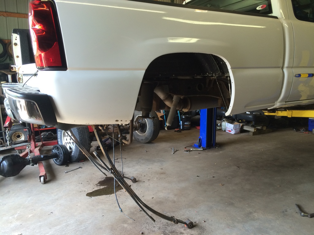

14 bolt install pics. The rear brakes are a lot more powerful with such large drums now.

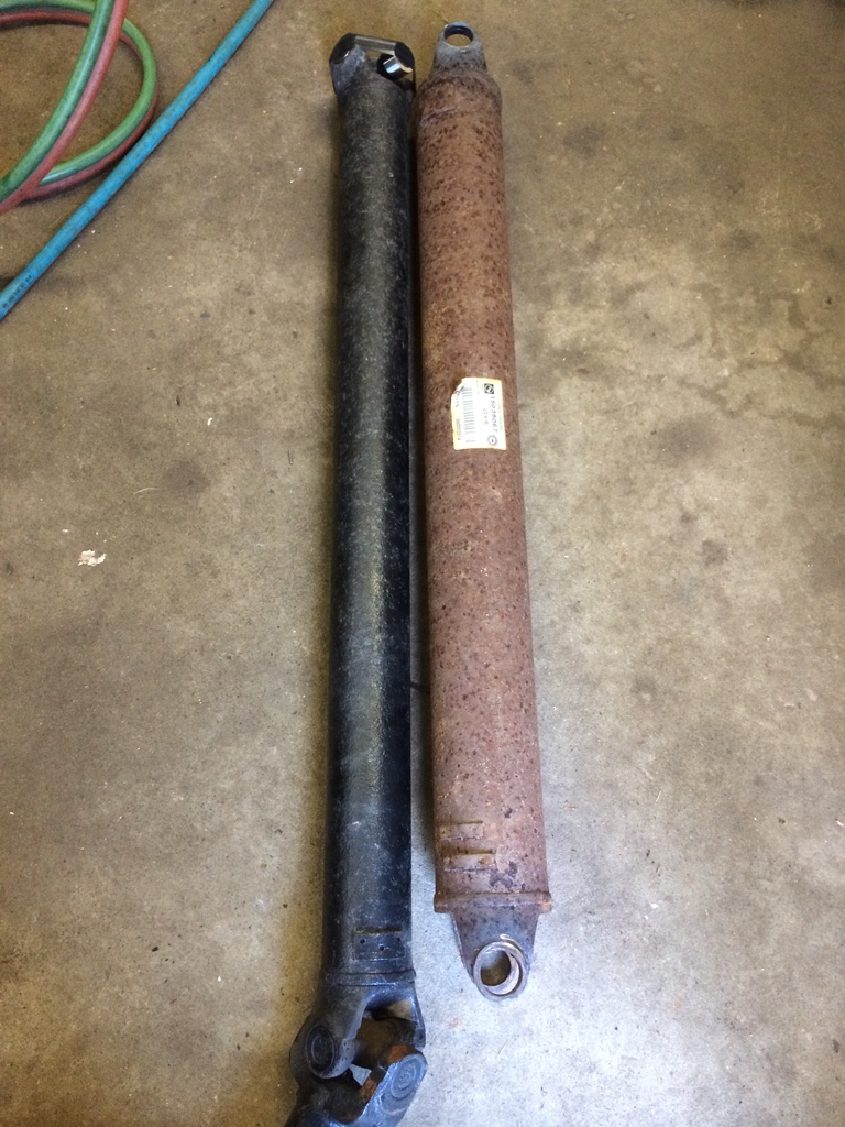

I used a drive shaft from a 1999(?) Astro Van. It had the correct front U-joint for the 4l80e and also the right one for the 14 bolt. Astro Van is on the right.

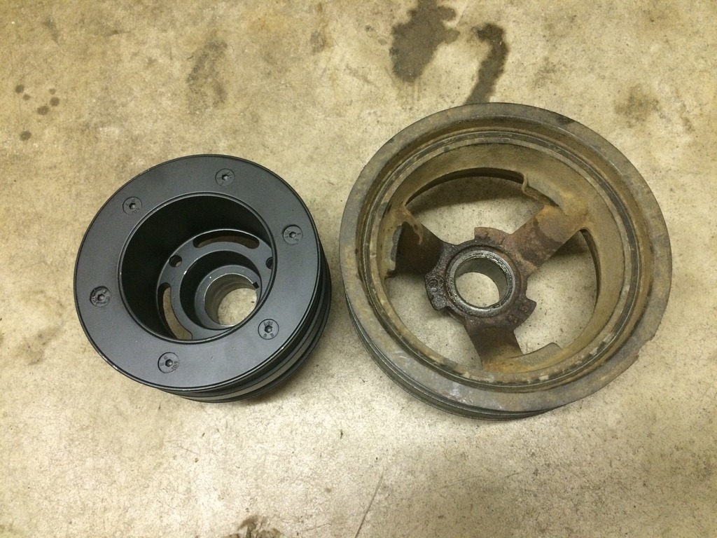

More goodies that I installed this year. Trunion and balancer.

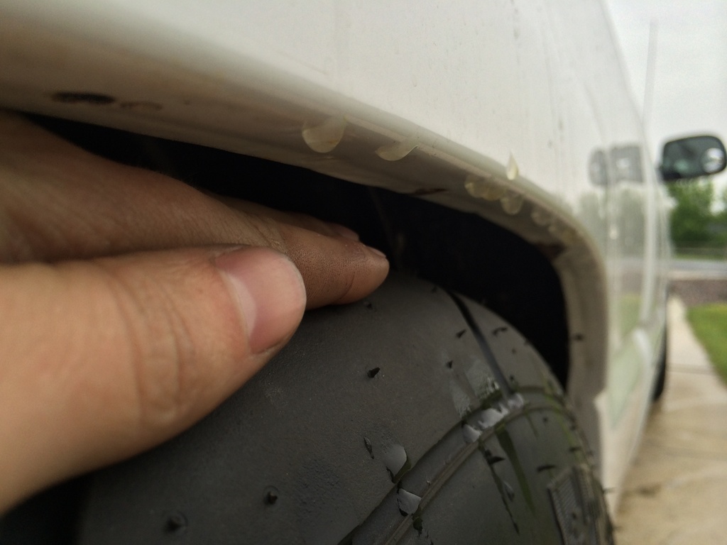

I measured my wheel fitment a little too close... I ordered a 1" lift kit for the rear to fix this, haven't installed yet.

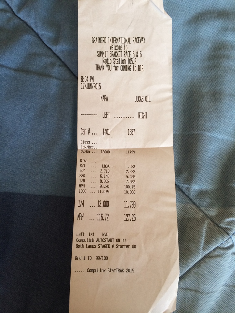

11.7 sec, 128mph. I have a lot of driving practice to do, notice 60ft. There was still some spinning and I should have let more air out of the tires. I hauled the slicks up in the box and swapped at the track.

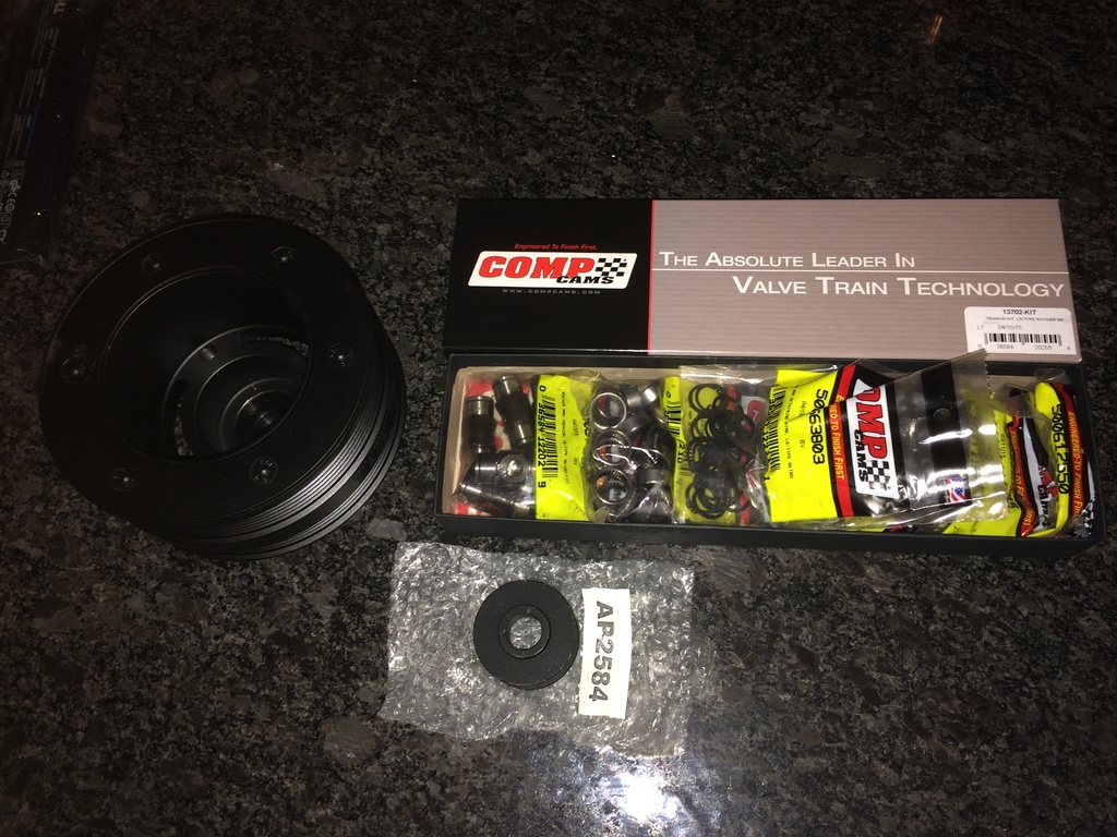

Trick flow balancer install.

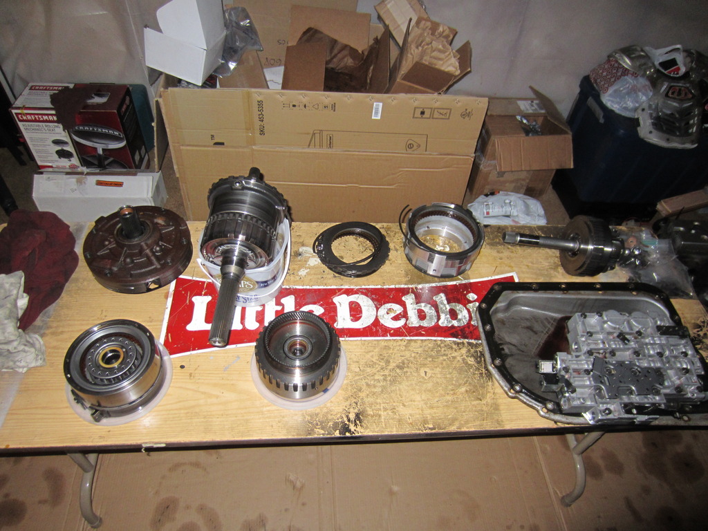

Also, I broke my transmission in August at Powercruise. Lost every gear. I hauled it home and it drove off the trailer fine... I did some more driveway testing and found that it would keep pressure for about a minute and then go out. Shut truck off, restart and it was good for another minute. Trans pump is perfect and there is no major noticeable damage. I bought an updrage/rebuild kit from Jake's Performance and am slowly going through it, I mean very slow. I haven't gotten much further than this pic. Been too busy with many other things.

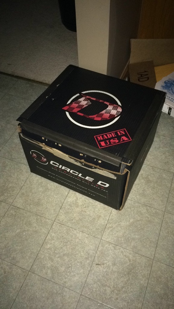

And while I'm at it, I also bought another Circle D converter. This time a triple disc 1A stall speed. Currently I have a single disc 2B.

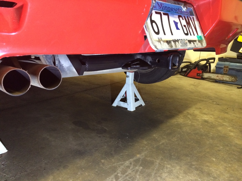

Built a custom hitch for my CRX for my stand up ski. It's a waste driving the truck every time for something so small.

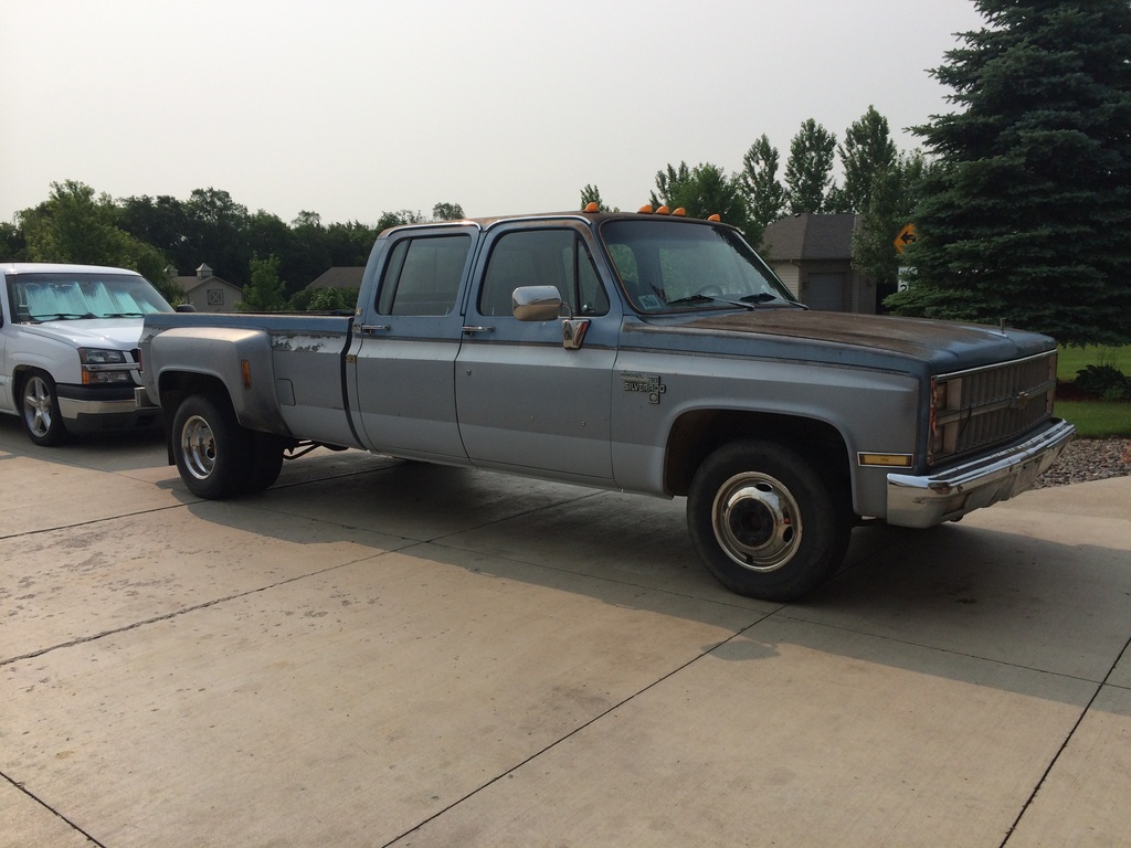

The 1982 dually that I mentioned in the previous post. It currently has a 4 speed manual and revs round 3k rpm on the highway. Burns so much fuel.

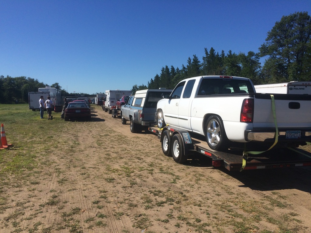

The line to enter at Powercruise

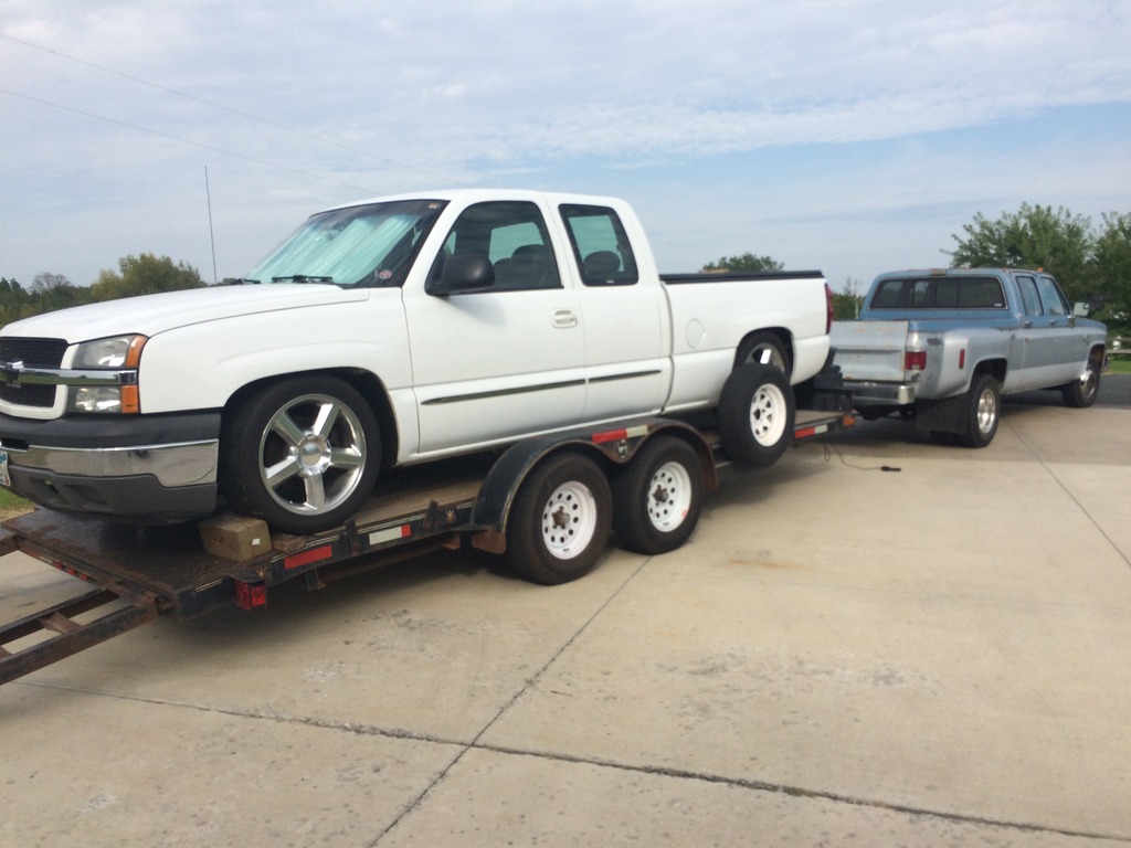

Towing to my friend's house to do the transmission install after I wrecked my good one. the trailer winch I installed in the spring worked awesome.

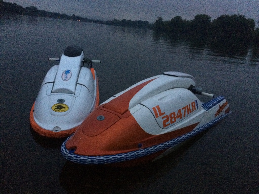

Then bought another jet ski (right). A buddy drove to Illinois to buy these two. Stand up skis sell pretty high in MN so it was worth it.

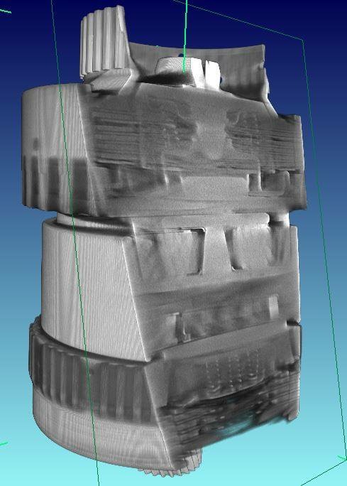

And I work at an X-ray manufacturer and got to bring in some of my transmission parts for fun before I took them apart to see if I could spot anything abnormal. Couldn't see anything wrong in these drums.
