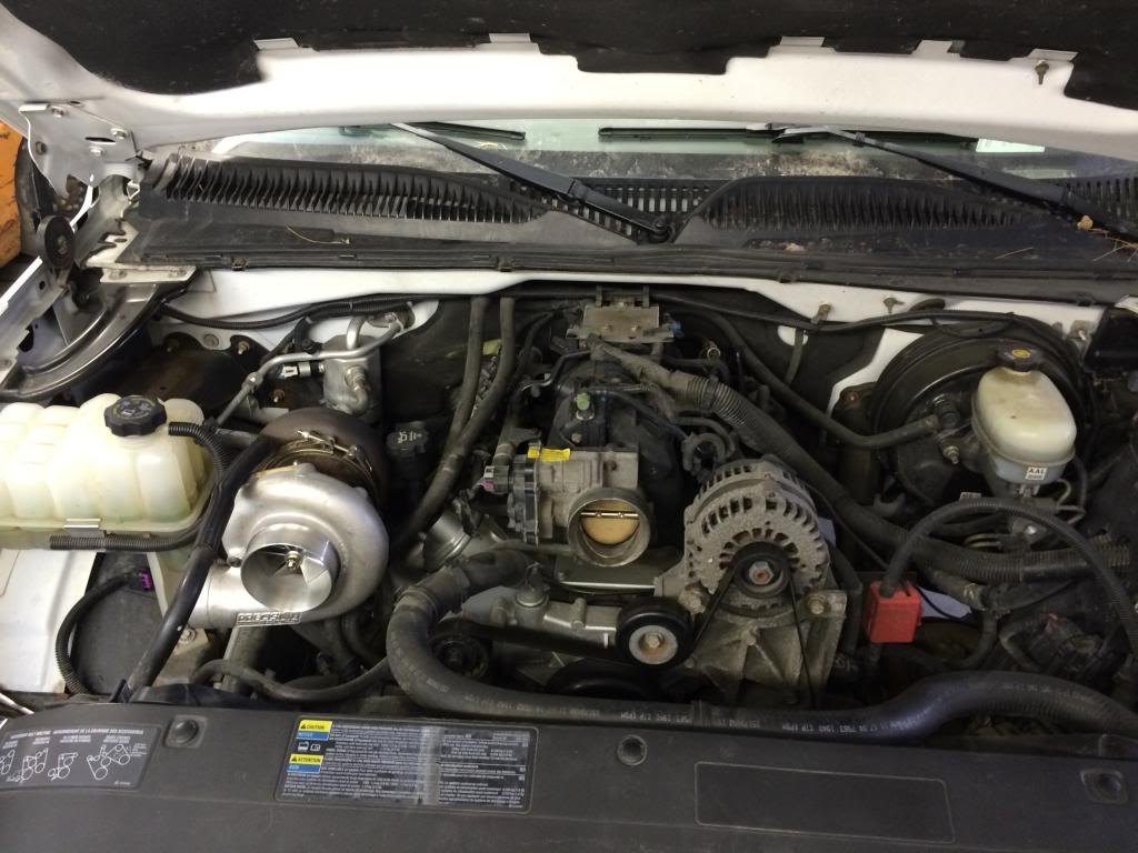

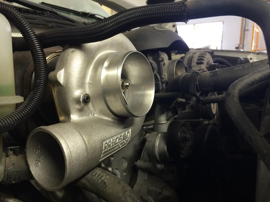

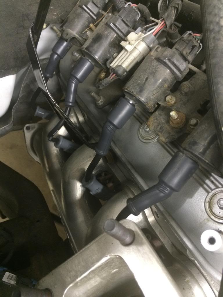

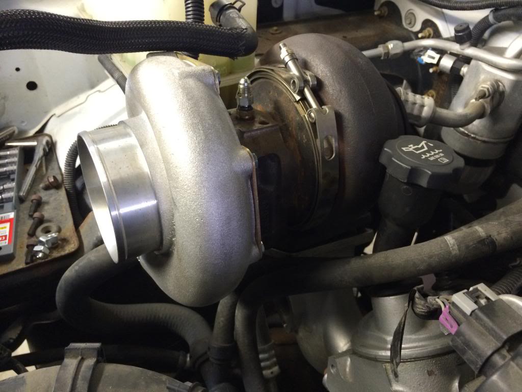

I pulled the stock passenger side manifold off to test fit the trick manifold. It fits pretty awesome! Should be plenty of room for a custom down pipe and the oil dipstick even bolted right back up to the head with only a little grinding needing to be done on the mounting tab of the dip stick.

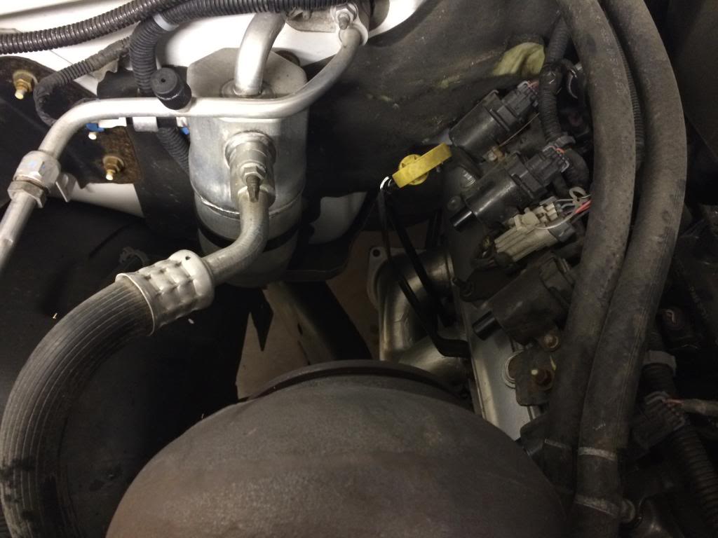

I was a little stumped on the A/C line clearance so I got on the forum and did some searching. I grabbed the fitting with a crescent wrench and yanked it over and out of the way so it now aims forward.

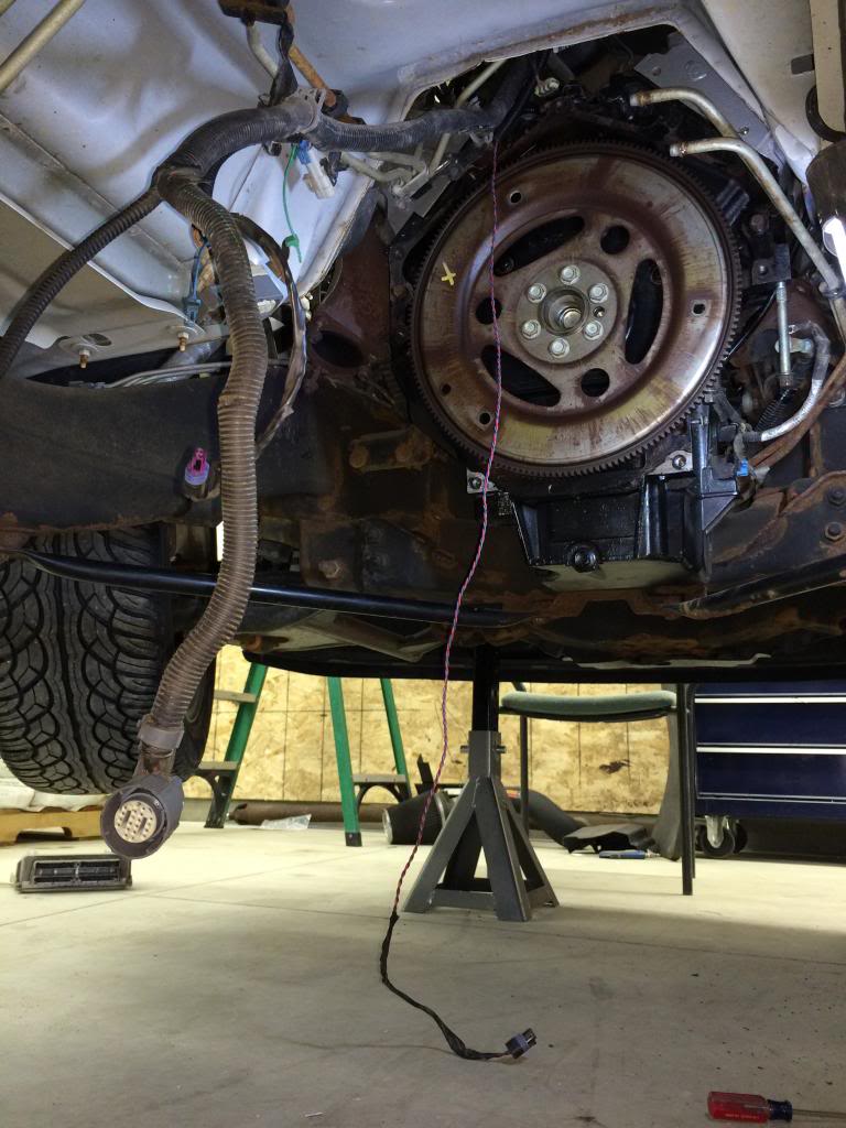

Also ran the 4l80 input speed sensor wire and terminated it in the computer (pins 22 and 23 on the green connector) Picture is before I ran it through the loom to the NSS.

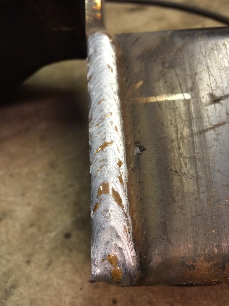

And then cut and welded gussets at an angle so they don't hold too much sand and dirt.

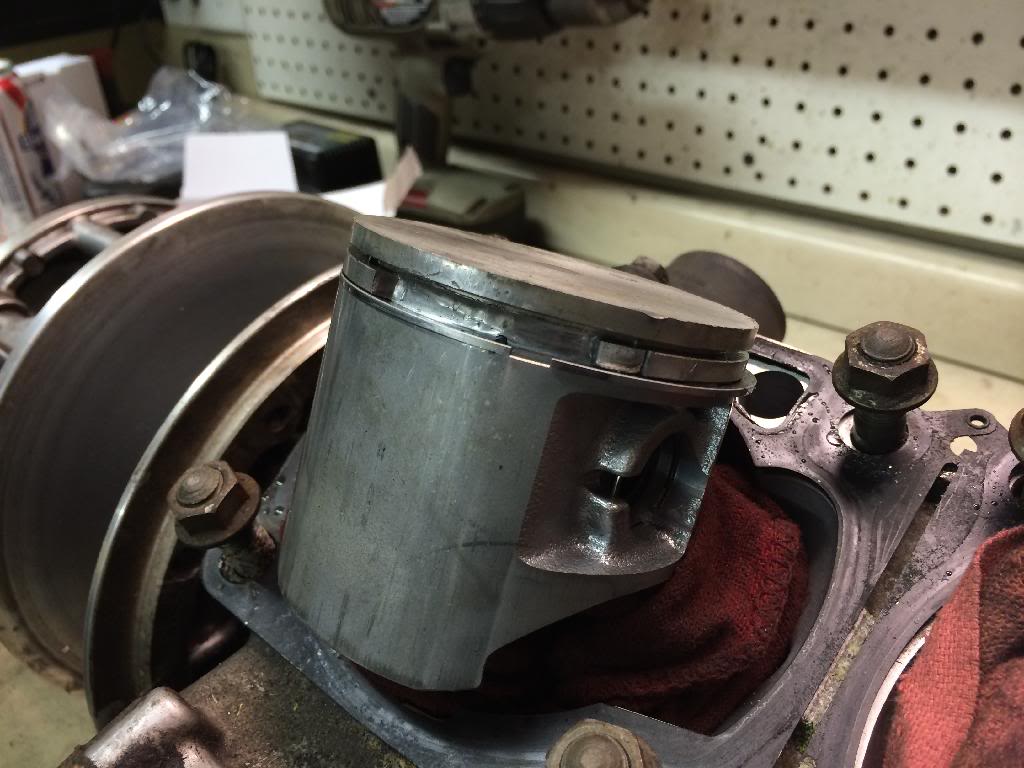

Looks good man, I spot a 2 stroke piston in one of your above pics.
Old Mar 16, 2014 | 06:14 PM
cpolaris502's Avatar
Joined: Jul 2012
Posts: 299
From: Minnesota
Ha, yup. Just finished a top end in a buddy's 1998 ZR600 a few days ago. No other damage, the chunks stayed between the rings until we pulled the cylinder.

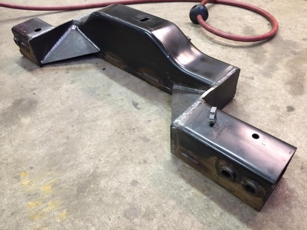

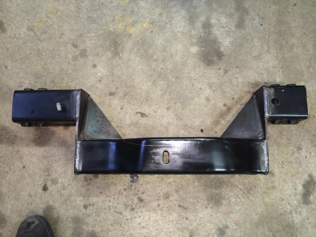

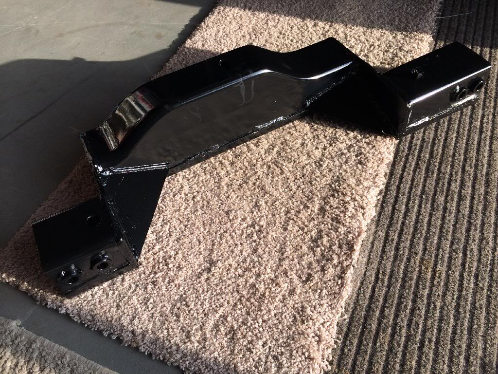

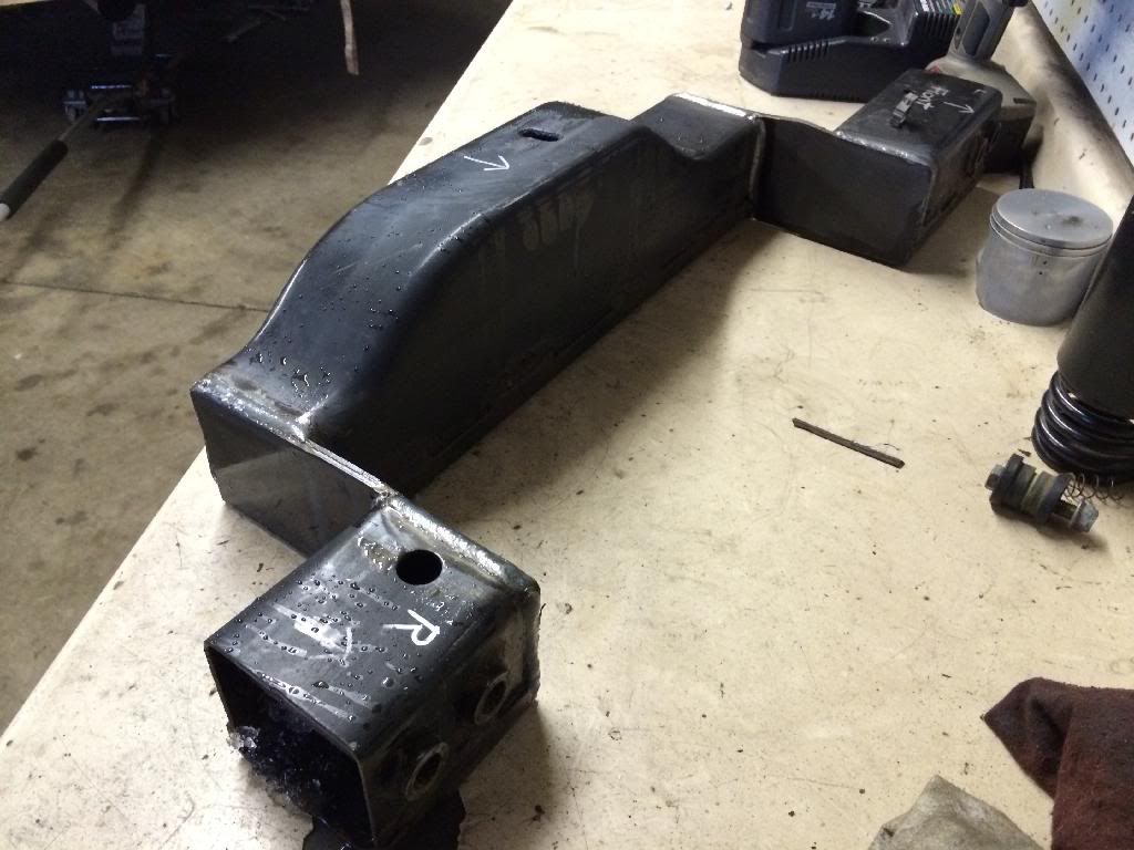

Painted cross member

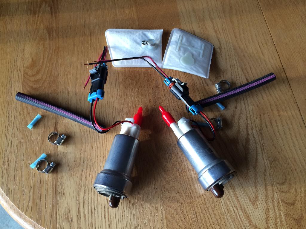

Dual Walbro 450s that I'll have to figure out how I'm going to stick in the stock bucket.
The trick manifold requires angled plug wires so I made those.

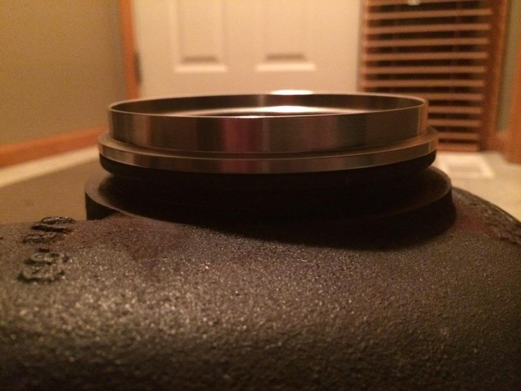

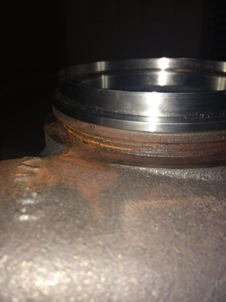

And then had a buddy make me a down pipe flange to fit the PT88 so I wouldn't have to spend an effing $120 through precision. He made a few more if anybody else needs one too.
