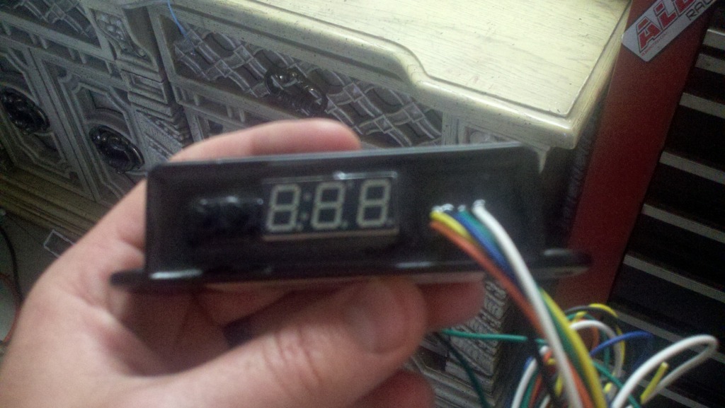

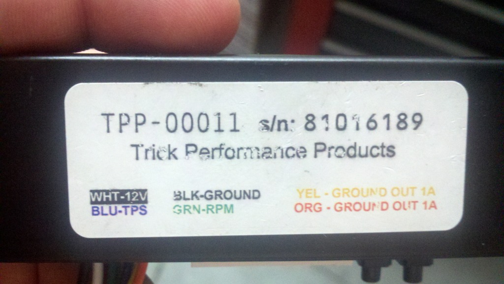

so a buddy of mine gave me this lil' gem but im not sure what all wires i need to hook up. i just running a single stage plate kit.

there are 6 different wires and im not sure where im suppose to tap into for each source any help would be great!! thanks guys.

Here is the install manual for it if that helps :
http://www.trickturbo.com/images/908ws_instruction.pdf
I have that same switch works like a champ!

mine works great... follow those instructions and you will be on your way..
