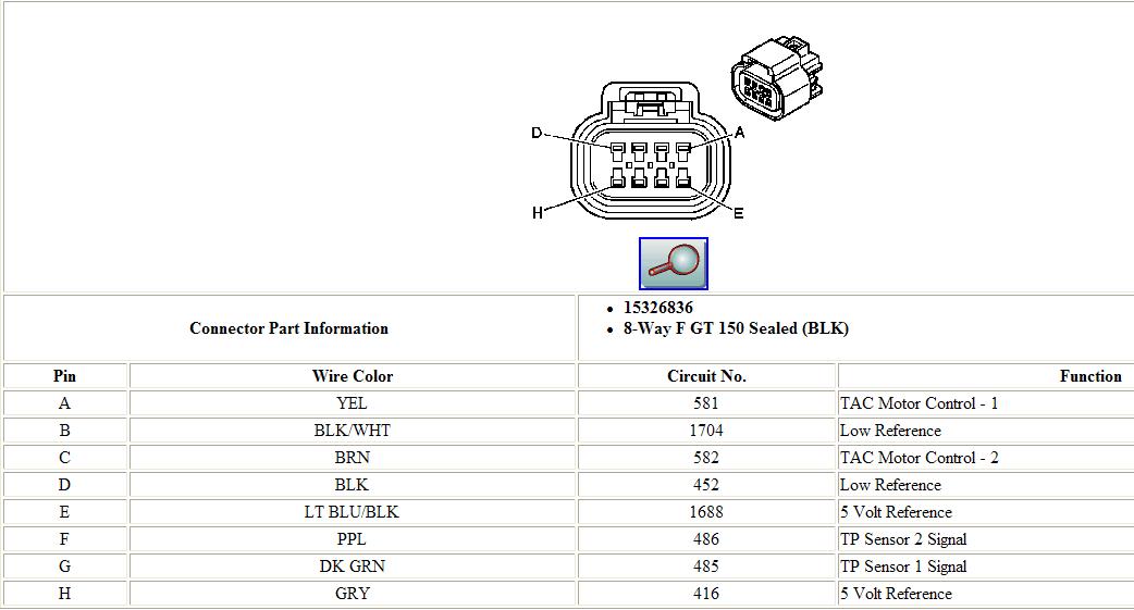

Does this attached file help Josh???

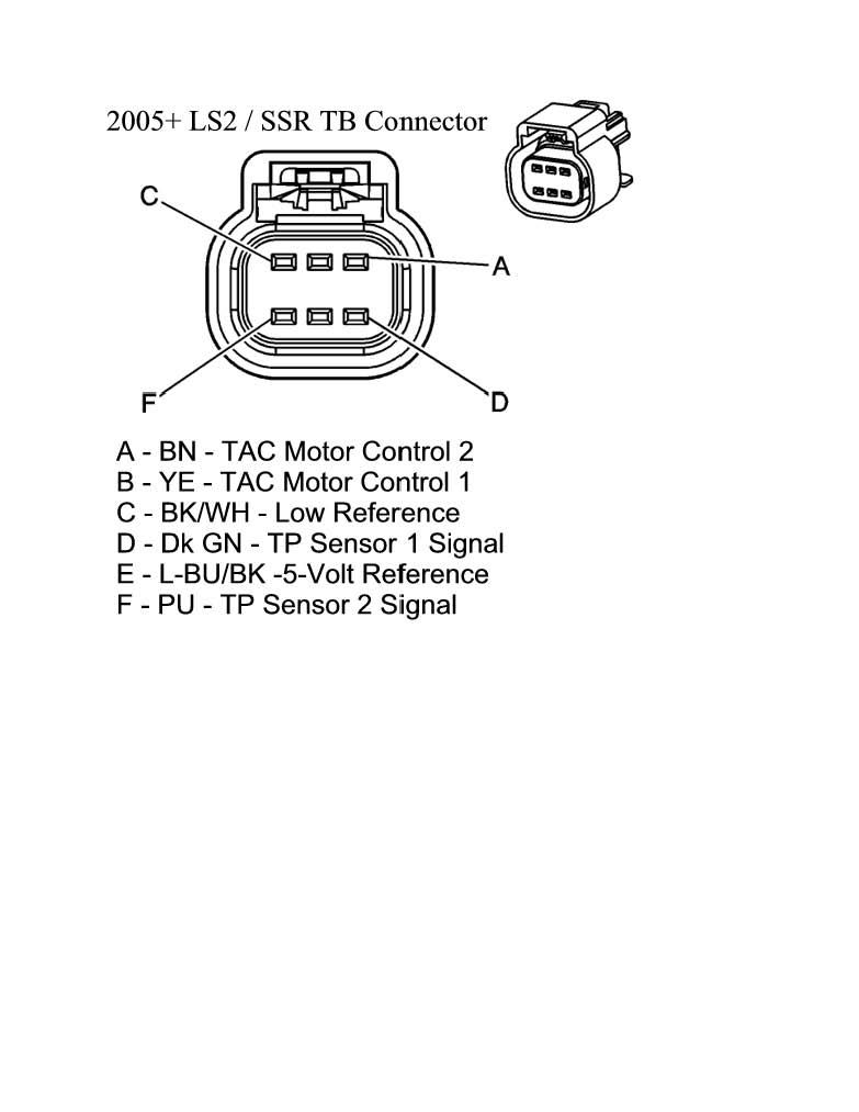

These are the factory harness wire colors.

Did it end up being the bottom right wire when you are looking at the plug (the dark green one)?
