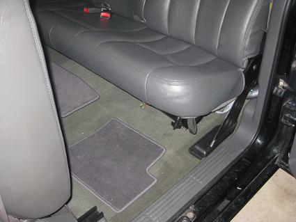

i was wanting mine side to side but i cant see anyway to make it work

mine is mounted side to side under the passenger side bench. it fits.

when i had it on mine it was under the back seat

the blowdown tube vents to outside the truck right? hard to see in your pic due to the lines
Yes, down through the floor to the outside, that is regulation. It may work but it's not suggested to mount the bottle sideways
