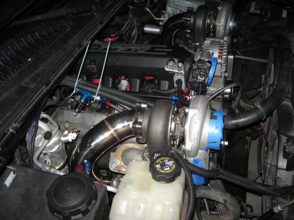

Smokeshow, that's a really nice setup, what size turbos? That trick tank looks like it's plastic though, I like that the nitrous outlet tank is metal, stainless or aluminum I'm assuming.

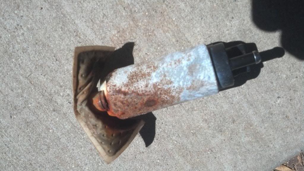

The turbos are GT35r. My gas tank is plastic too I put 100% methanol in that trick tank and the only thing that had a problem was the pump. This is after purging the tank with distilled water after only 3 times using the nitrous, too.
