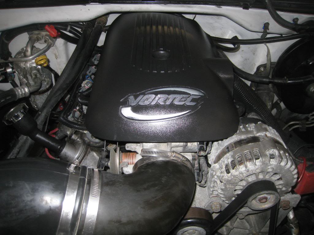

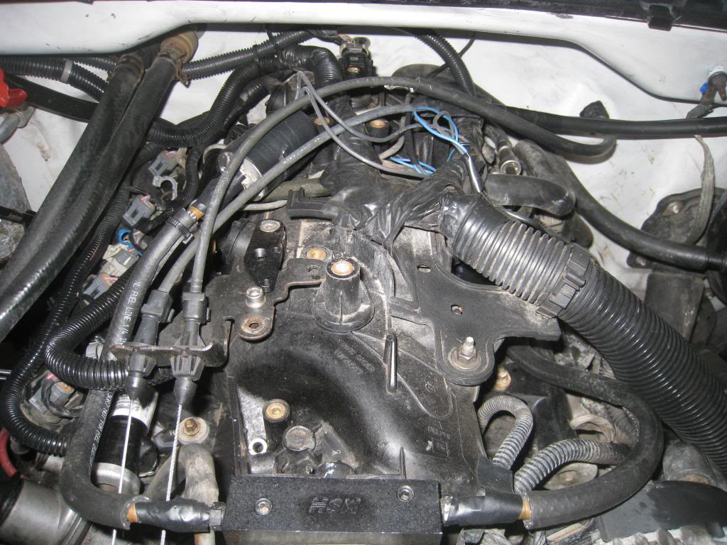

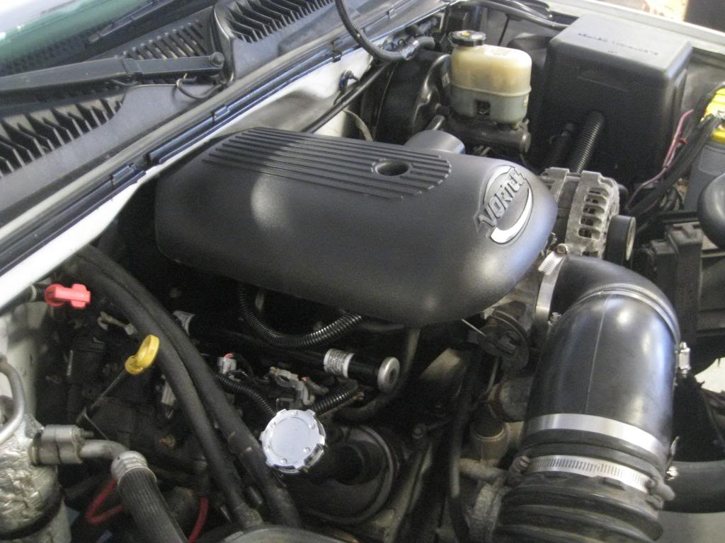

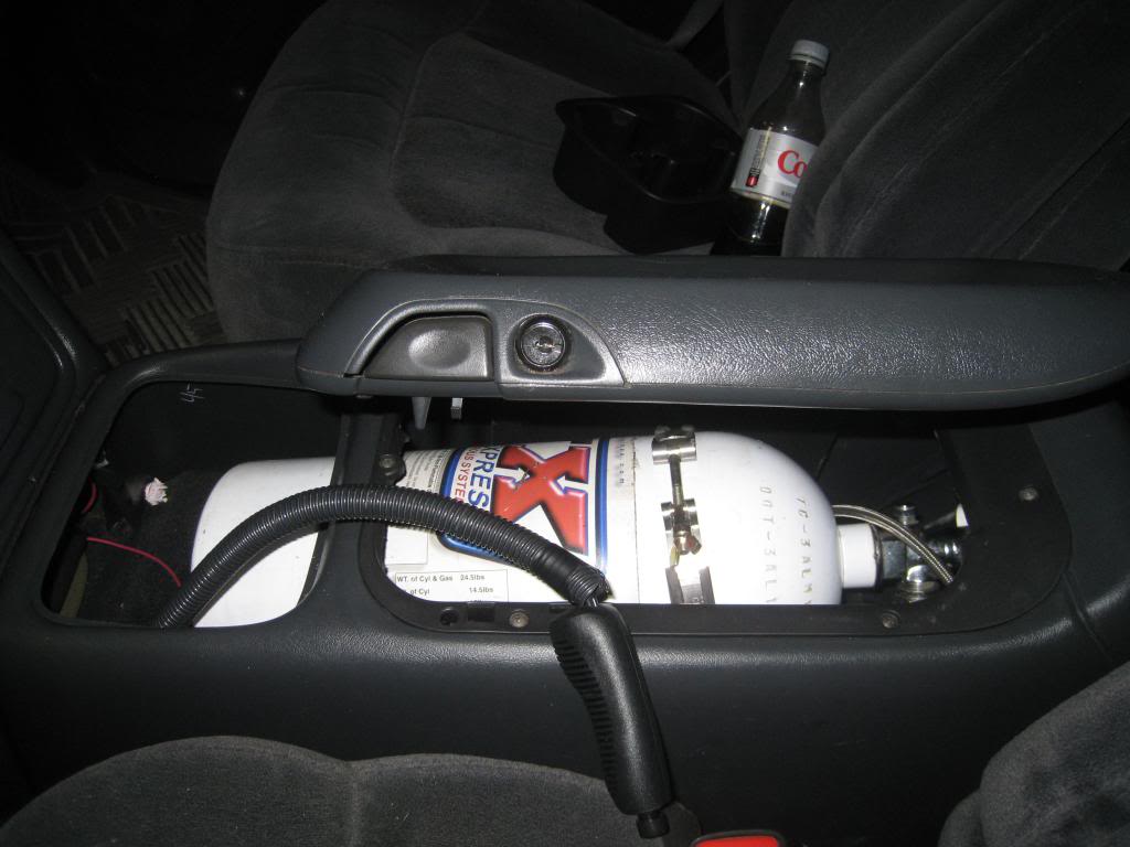

Nothing special.....going to try to make a little small change off of some stock sports cars and chargers,etc, so I made an attempt to camo the setup. I think it will keep under the radar of the people I'm looking to race. All of these pictures was taken with the flash and with the camera at the angles to view under the cover so you can get a good view of how its all done. Without the flash, its pretty well hidden from prying eyes.

A few pics without the flash......kinda like a "how you would walk up on it" view

That looks awesome! Defiantly have to do a little digging to find that. You may however have problems with picking up liquid nitrous with a low bottle with the siphon tube facing forward like that.
Trey
Thanks Trey! You're def right there. It might end up being an issue. I'm trying my hardest to figure out a way to get the bottle turned around, but it just isn't quite enough room the other way to make it work. I did a little research on some past threads and the two guys I found that did this also said they weren't having any problems with them even when the bottles were getting low. That is pretty encourageing, but I'll def post up my findings as soon as I go through the first bottle.

You should paint the plate flat black and throw some oil on it then go down a dusty road.. works great!!
Mine was all behind the intake manifold down by the oil pressure sensor ha.
Ha ha........and I just got the months of sitting up cleaned off of the engine bay. I looked really hard at putting the noids down there but ultimately I got lazy and made them work under the cover. Didn't think about going flat with the plate, but it would def look more like part of the intake that way. Good idea!

Originally Posted by brandon6.0
Don't think I have seen a more hidden setup. Very nice! How much juice u puttin to it?
Thanks guys! I really took some time and tried to get it all to look like it was originally there. Now to see if it works on the street. Brandon- Currently its pilled and tuned for a 150 shot.
