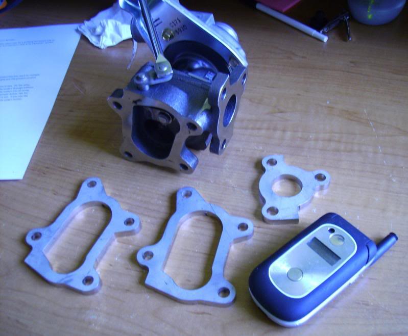

Here is the turbo. Its an IHI RHB31. They were used on Suzuki Swifts and Chevy Sprint Turbo cars in the early 90's. I was concerned it was just too big, even though it is the smallest turbo available. I am no longer concerned... read on.

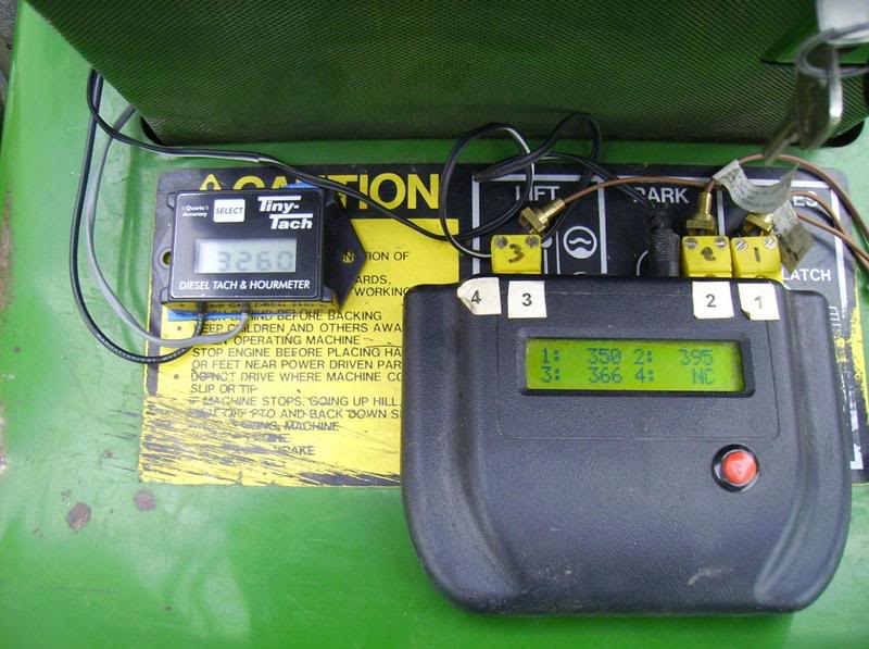

I added a 4 channel theromocouple reader and a tach to the tractor. I am currently using the 4 channels for: Intake Air Temp, EGT, Oil temp and Ambient. This image shows when I had 3 EGT's on each cylinder.

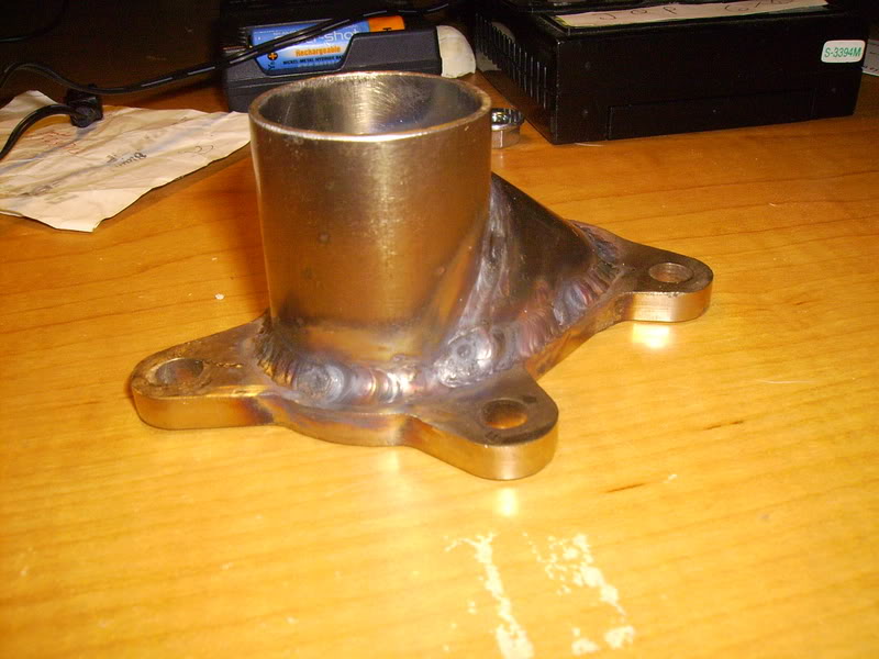

I used the exhaust manifold from a JD skid steer with the same engine to get it pointed up, then made an adaptor to to to the turbo.

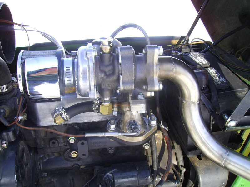

I welded a bung on the valve cover for the turbo oil drain. For pressure I teed into the stock pressure sender port and ran a -4an stainless line to the turbo.

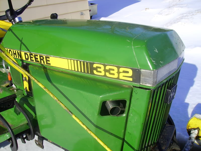

I build a "tail pipe" to get the exhaust out the stock location on the tractor. Tig welded stainless steel of course.

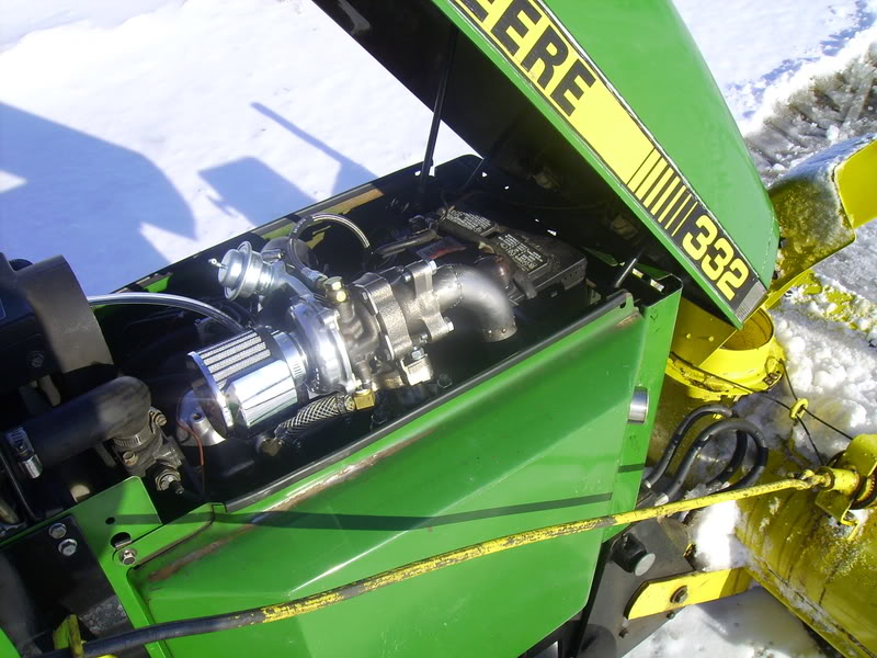

It all fits under the stock hood/side panels with no modifications.

I initallly turned up the fuel a minimal amount and saw 4-5 lbs of boost under heavy load with minimal black smoke.
After I turned it up some more it woke up. I am not seeing 10lbs of boost and lots of smoke. The highest EGT I have seen is 1100, but thats at 0 degress F outside. I will probably dial back the fuel some and relocate the air filter before spring/summer.
