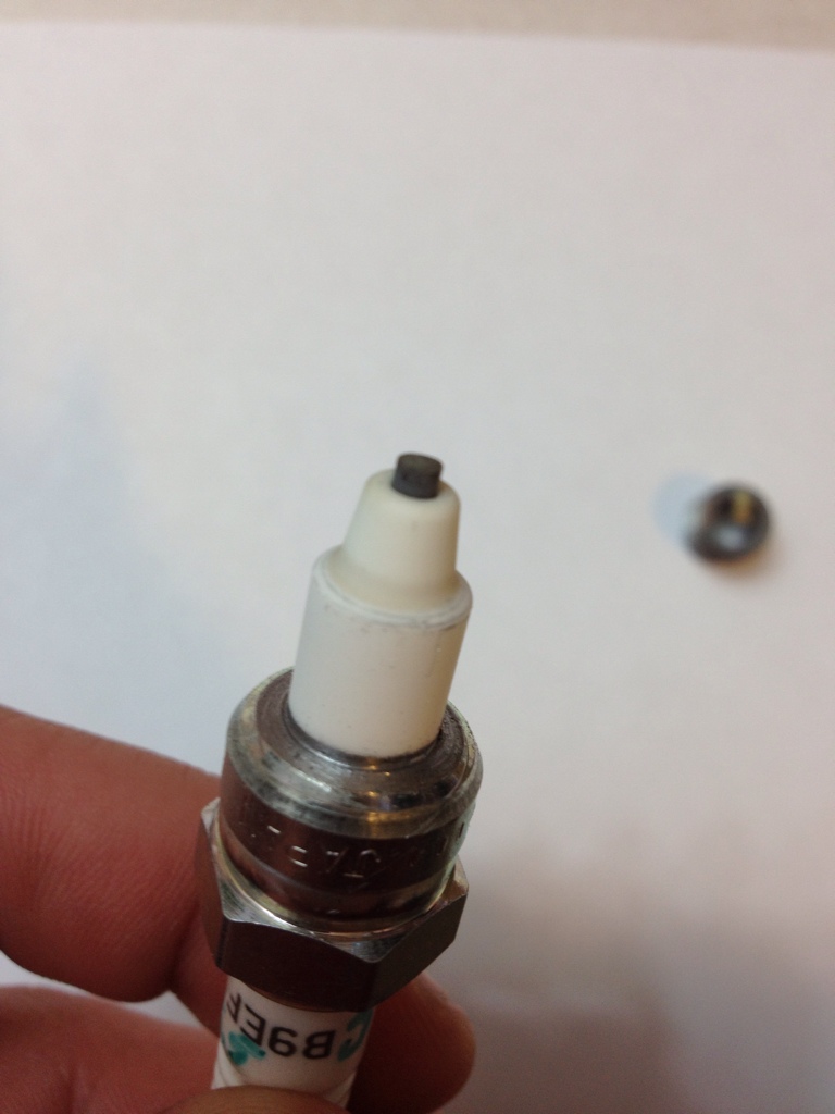

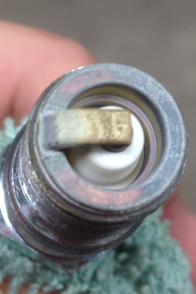

is that detonation on plug 1, or just a little crud? did you guys cut the threads to look at the fuel line? you guys are on the right track. i've seen big gains by fine tuning the nitrous setup...most people slap in the recomended jets and drop timing and go and not realize that they can drop several tenths by fine tuning the nitrous.

No detonation. Just crud from the crappy oklahoma 91 octane. Didn't cut the threads. I can see without. Tune is in check. Going to finish it up at the track. May be able to clean the fuel up a little more and I'm pretty positive it will take a few more degrees of timing
A better look at run #3. You can see a faint grey line at the base. It's close
What's this plug telling you?
