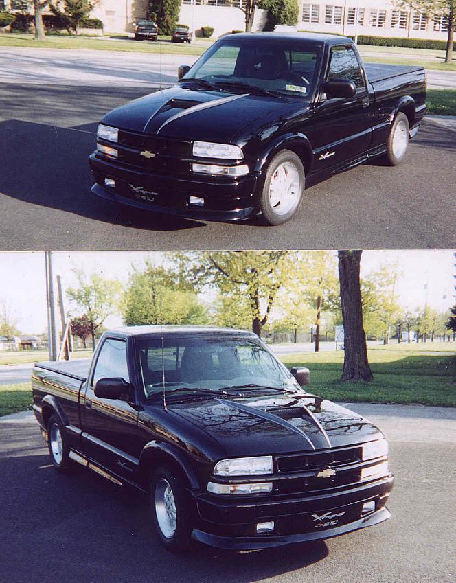

the S-10 extremes had a 16x8 with a 5" back space. hope this info helps.
btw i had 275x50x16 tires on the rear with no prob and 255x50x16 front.

Yeah thanks man
If that's your xtreme it's nice!
