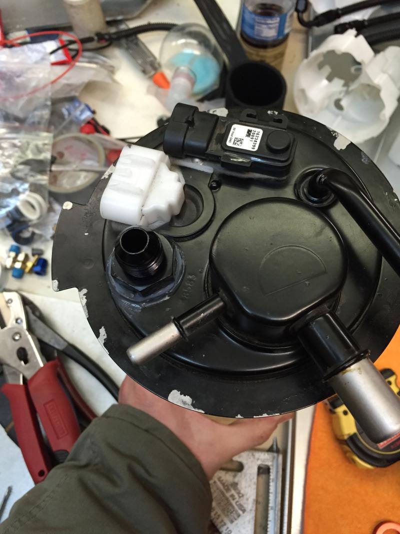

Hey fellas, I was curious as to what bulkhead fittings have you guys used before to run the feed line out of the stock hat?
I bought these two fittings the 90 is a Russel and the straight a summit brand.. I was surprised to see that the Russel one doesn't come with the nut nor the nylon washers.. So I went onto Russel's site and the way they show them being used is without the washers....

<p>I used nylon washers on mine.&nbsp;</p><p>&nbsp;</p><p>Name:  6BCAE029-1354-46FC-B7BA-03A9E21C48F3_zpsxsebionh.jpg

did the nylon washers come with your fitting? and what brand is your fitting? thanks..

Fuel cell bulkheads come with the washers. I used aero quip fittings.

<p>Mine is Fragola.&nbsp;</p>
