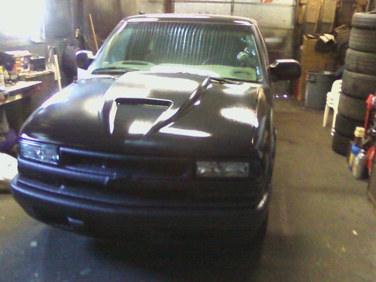

Its well worth having one they are fun but a real pain in the a$$ to work on and its sometimes more touble than anything but heres a couple of pics on how mine looked when I had it, but it was well worth it when mine looked like a sleepr
Attached Thumbnails "Project LS10"-img_0035.jpg   "Project LS10"-img_0036.jpg   "Project LS10"-img_0004.jpg
