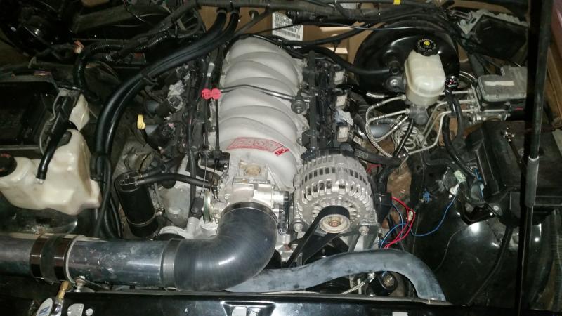

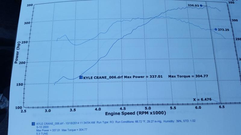

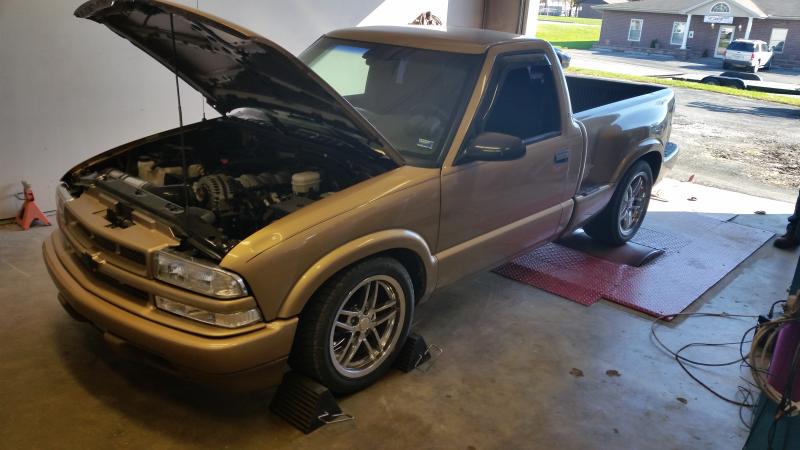

337HP/304TQ RWHP

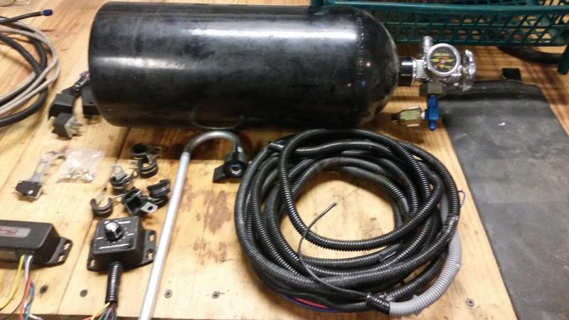

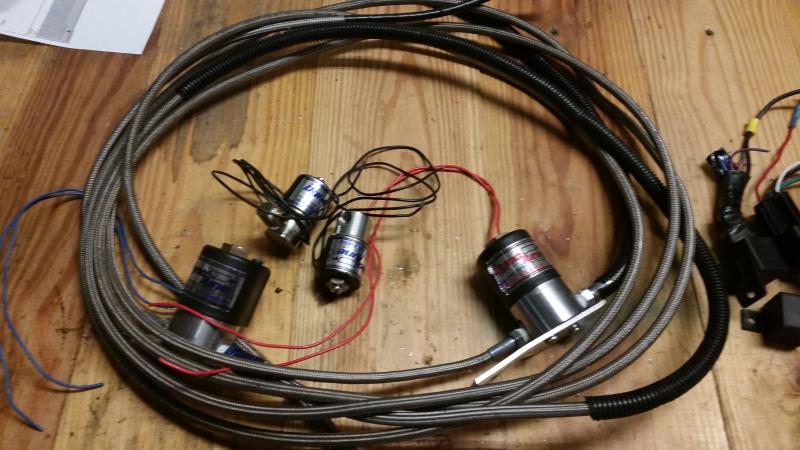

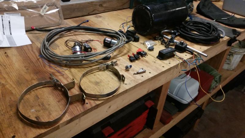

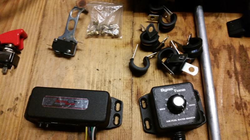

Starting the long install of N20. Here is what I have to install.

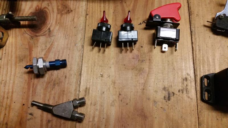

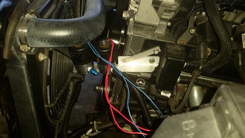

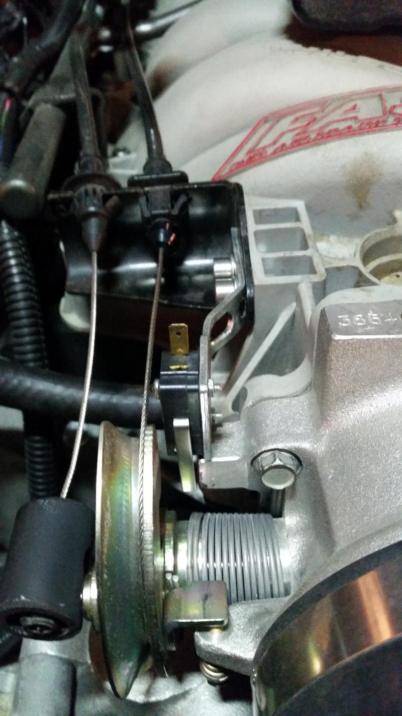

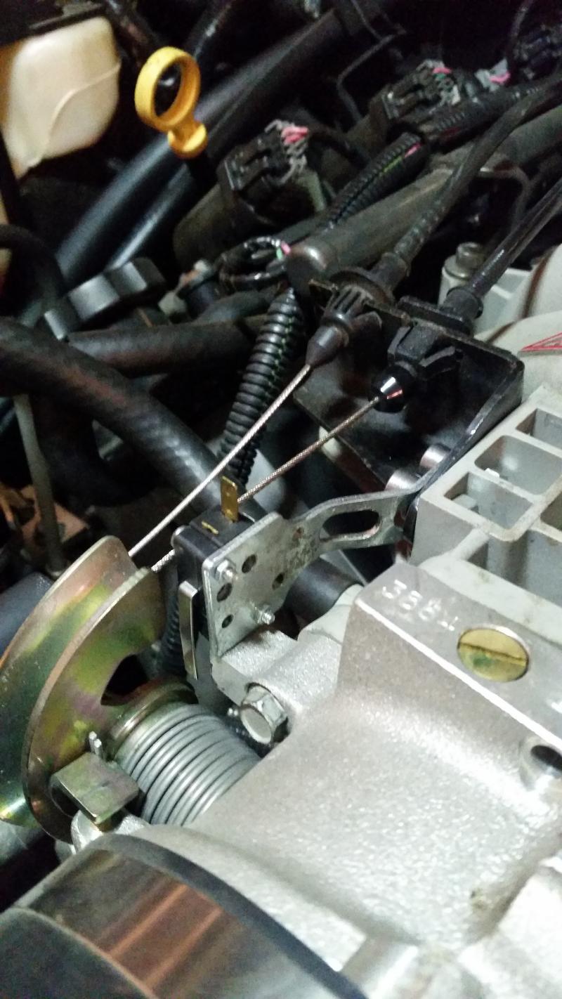

I just installed the WOT switch and the purge nozzle.

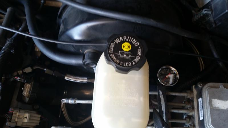

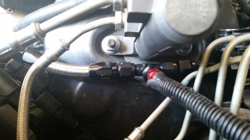

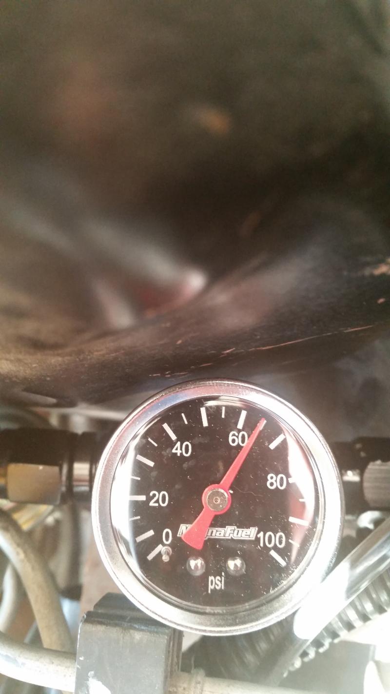

I finished up the fuel line on the truck and checked the fuel pressure.

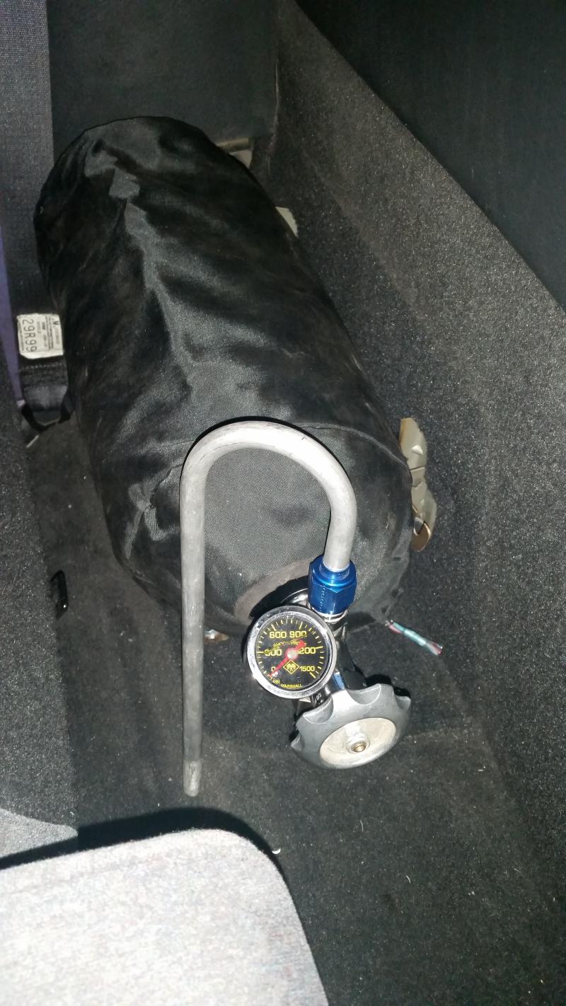

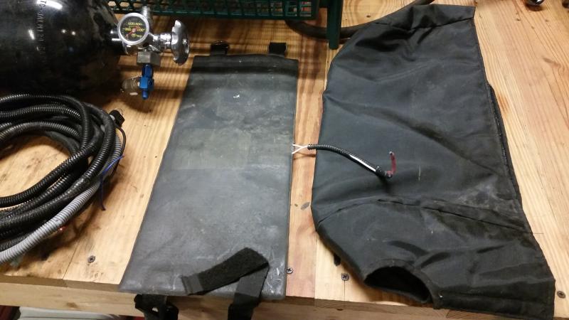

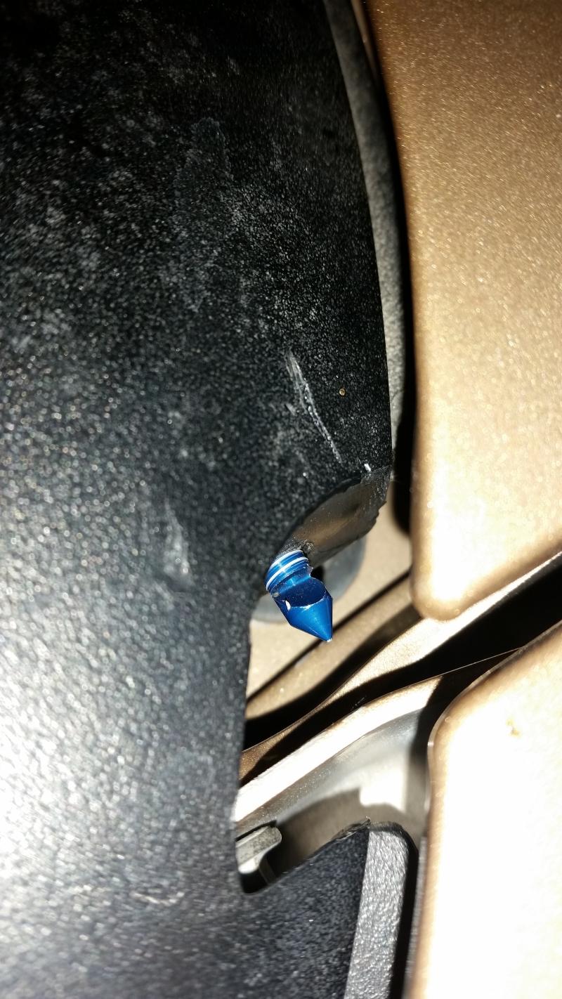

I also installed the bottle, heater, and blanket behind the passenger seat. I can still put the seat all the way back to match the drivers. The blow down tube is just there it will go on the other side.
