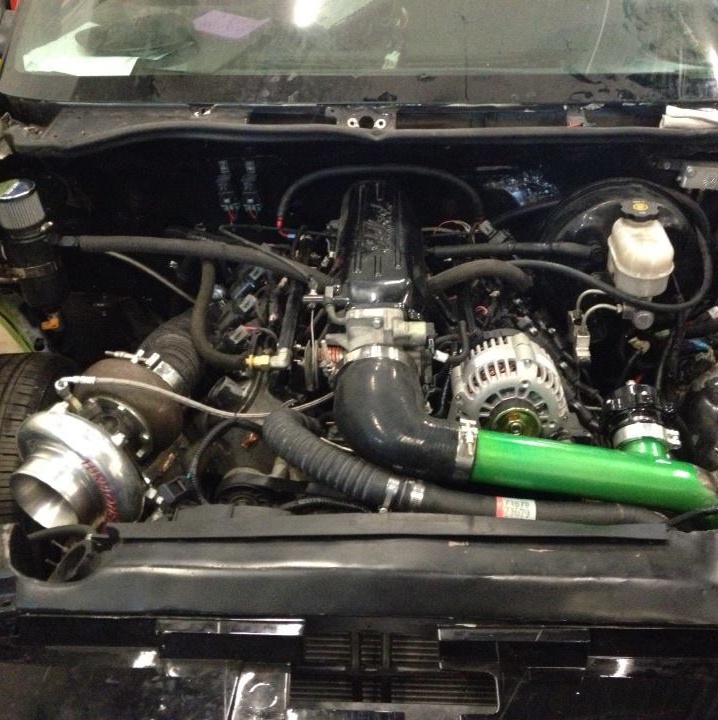

Update: got truck started again two nights ago. Sense the last post i relocated the wide band into the new down pipe, added a o2 sensor in the exhaust manifold, cleaned up and removed all the zip ties we used to get the wires together on each side of frame rails and replaced them with the rubber isolators that are zip screwed into the rails, as well as made a turbo back exhaust to exit out the bed down low where it did with the rear mount before.
Im sure we did alot more but i cant remember rite now. The truck started up quickly after i turned the key but had a very very bad misfire. We tracked that down to a coil pack on drivers side in the back. I had org bought ebay oem style coil packs for $90 new. Now i see why. on startup with the rear mount before 3 were bad from get go and two days ago when i started with the front mount 1 more is bad. Solution was to put stock coils and valve covers that came with this junkyard 5.3 back on the truck. Problem solved. Then i went to bleed brakes only to find out i had a bad proportioning valve in the system so we replaced that and there good to go, with new steel braided lines up front and SSBC calipers in rear. I am thinking about converting to hydro boost to clean up engine bay a little. Has anyone done this, if so is it worth it or is there any real difference? Other then that, thats about up to date so far. Tomorrow im going to patch up a few small pinholes we had in down pipe and exhaust, toping off fluids, changing oil and putting some fresh fuel in her. Sunday we are taking it out for some street tuning so im excited about that. Here this week i plan to do the following..
Make a ABS plastic gauge pod under the radio where the ac controls were for my volt meter, trans temp, and a spot for 2 toggle switches. Then im making a dash cluster out of ABS plastic also with a 3.5in speedo in the center, a 2 1/16 wide band, oil pressure, water temp and boost on each side staggered. I hope to add two green leds for turn signals and a blue led for high beams.
Also ill be putting my cowl hood back on and installing my flush mount aerocatch hood pins. I have a tri-fold bed cover im putting on the bed to. I sell HID kits at my shop so i will prob put a set of 10k in at this time. Im going to prob tint the windows and windsheild in the next few weeks, as well as add my shop name across the top center of my back window, and a list of a few of the major things we do listed down the center with our number and website at bottom center. Really happy we are just down to little bs like this at this point. Of course thats assuming i run into no problems while tuning.
