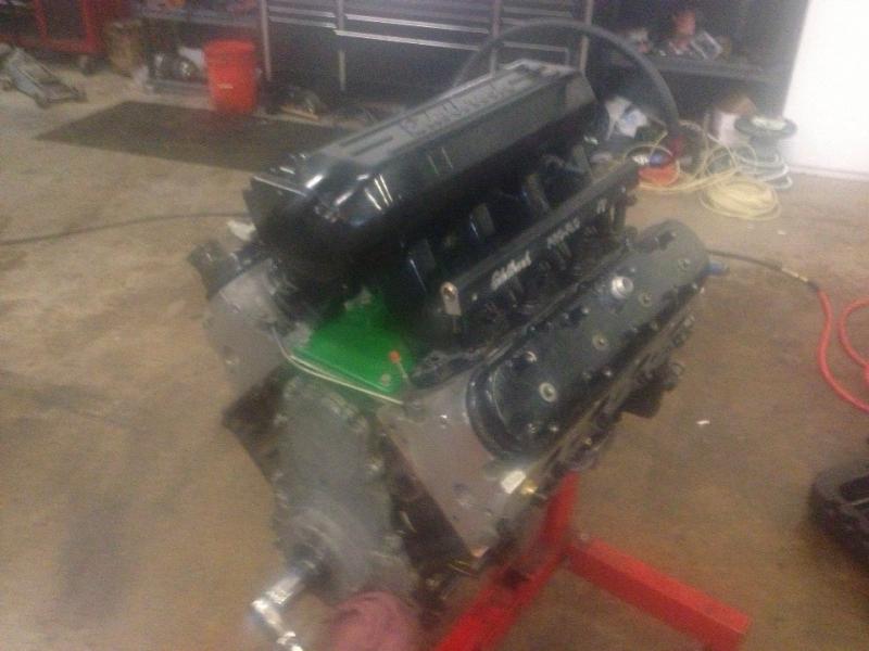

Motors built. Was very little buildup and sludge in it which i was real happy about. the truck it came from had motor pulled day after it was wrecked and was at my shop the following day so it didnt sit for long. There was a decent amount of slack in timing chain which had me worried tell i installed the 15k mile one out of my last motor to find out it had just the same, so im guessing that was normal. Ton of coating work tomm, so I'm not able to work on it tell tomm night. Parts for manifold will be here tomorrow. Ill be fabbing that up tomorrow night with pics to follow! Hoping we will have motor in and running by Thursday afternoon.

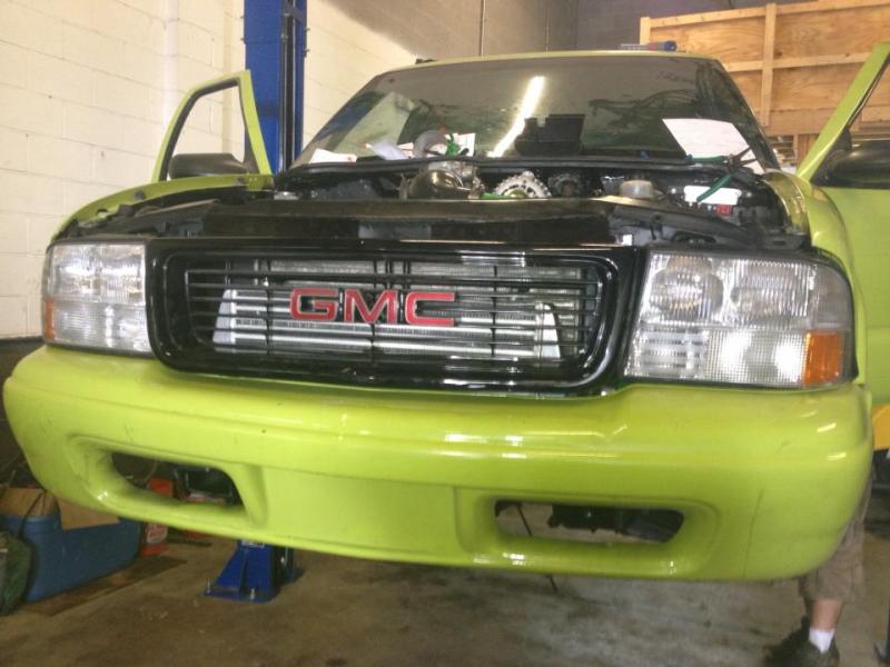

Black grill installed

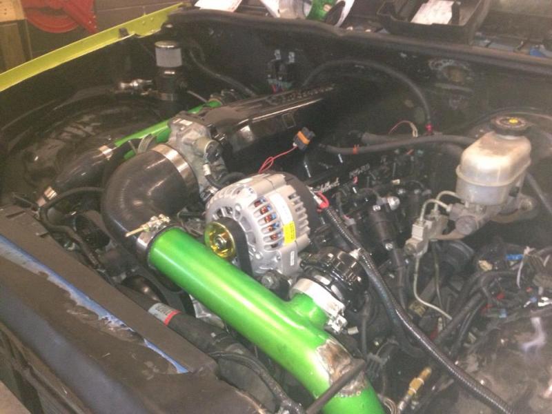

New motor installed with fender liners

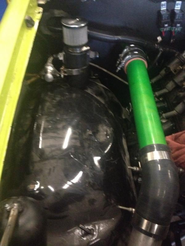

Intercooler peaking out

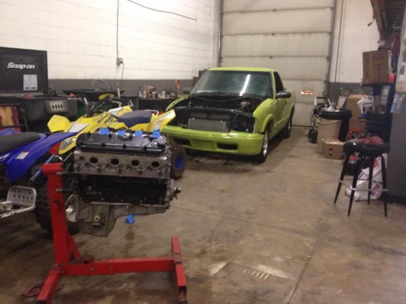

Motor getting ready to go in truck

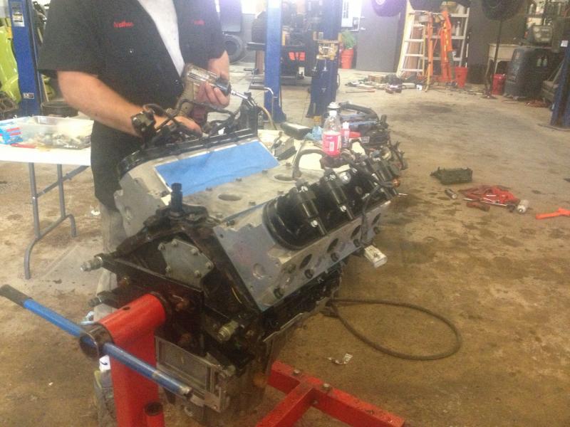

Putting valve covers and coils on motor

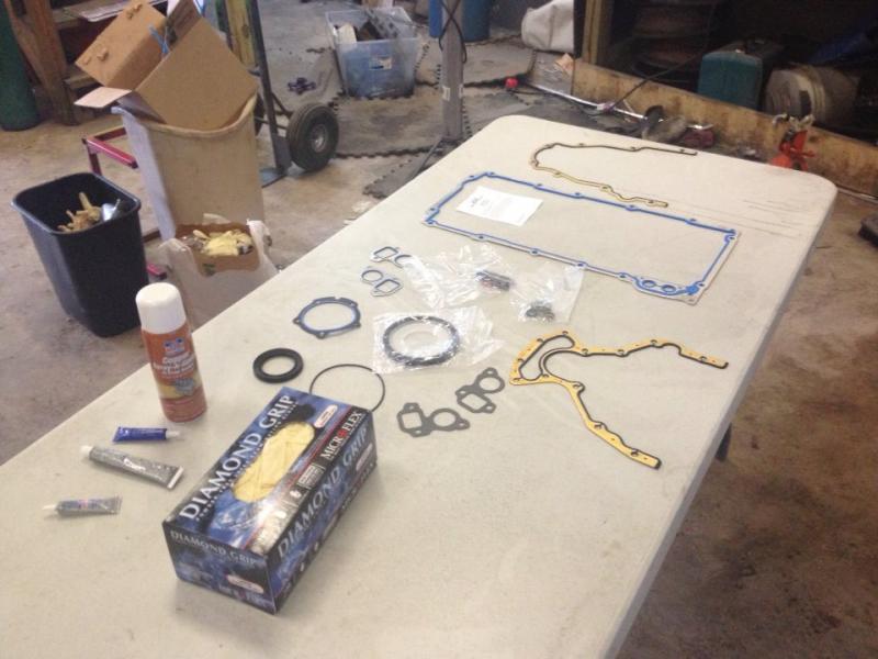

New gaskets

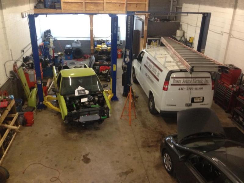

Overhead pic from powder coating area upstairs of downstairs of my shop

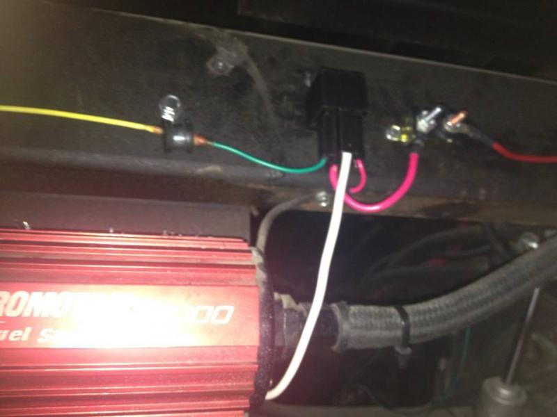

Rewired A1000 and rear oil pump to relay and circuit breaker

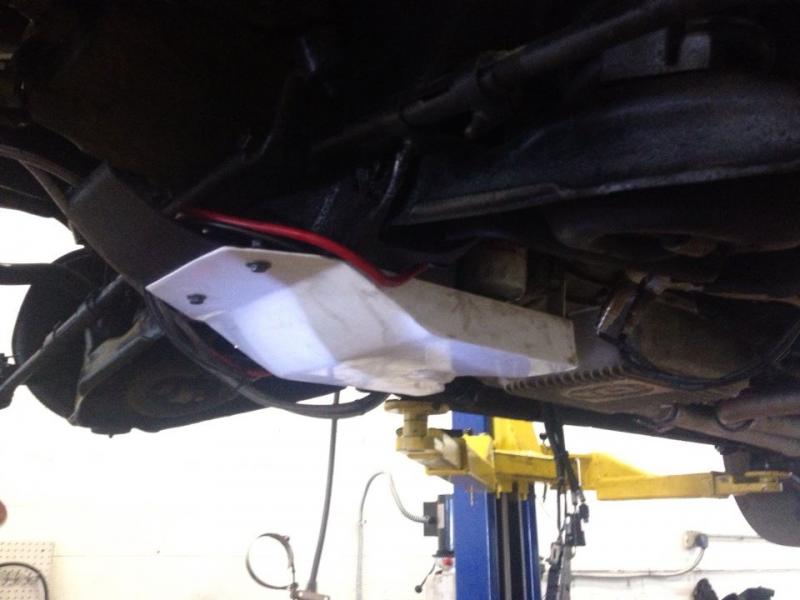

Skidplate i made and coated (dirty but you get idea) for truck pan

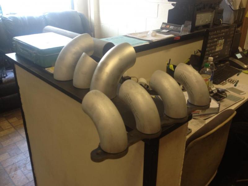

Parts for log manifold. (tubing looks alot bigger then it actually is)

Forgot to mention i fried an alternator that was on the truck because it was wired with the new harness to get 12volt+ when they only need 5v. I kept wondering why i had to toss a new battery in it every 2 hrs of getting it running and that was why. I ended up putting a 470ohm resister inline with the 1 wire to the alternator plug and that brought it down to the needed 5 volts. I should of known because the same thing happened with my ls1 mustang years ago and about 4 other friends i hang out with ls1 mustangs also. But you live and learn i guess
