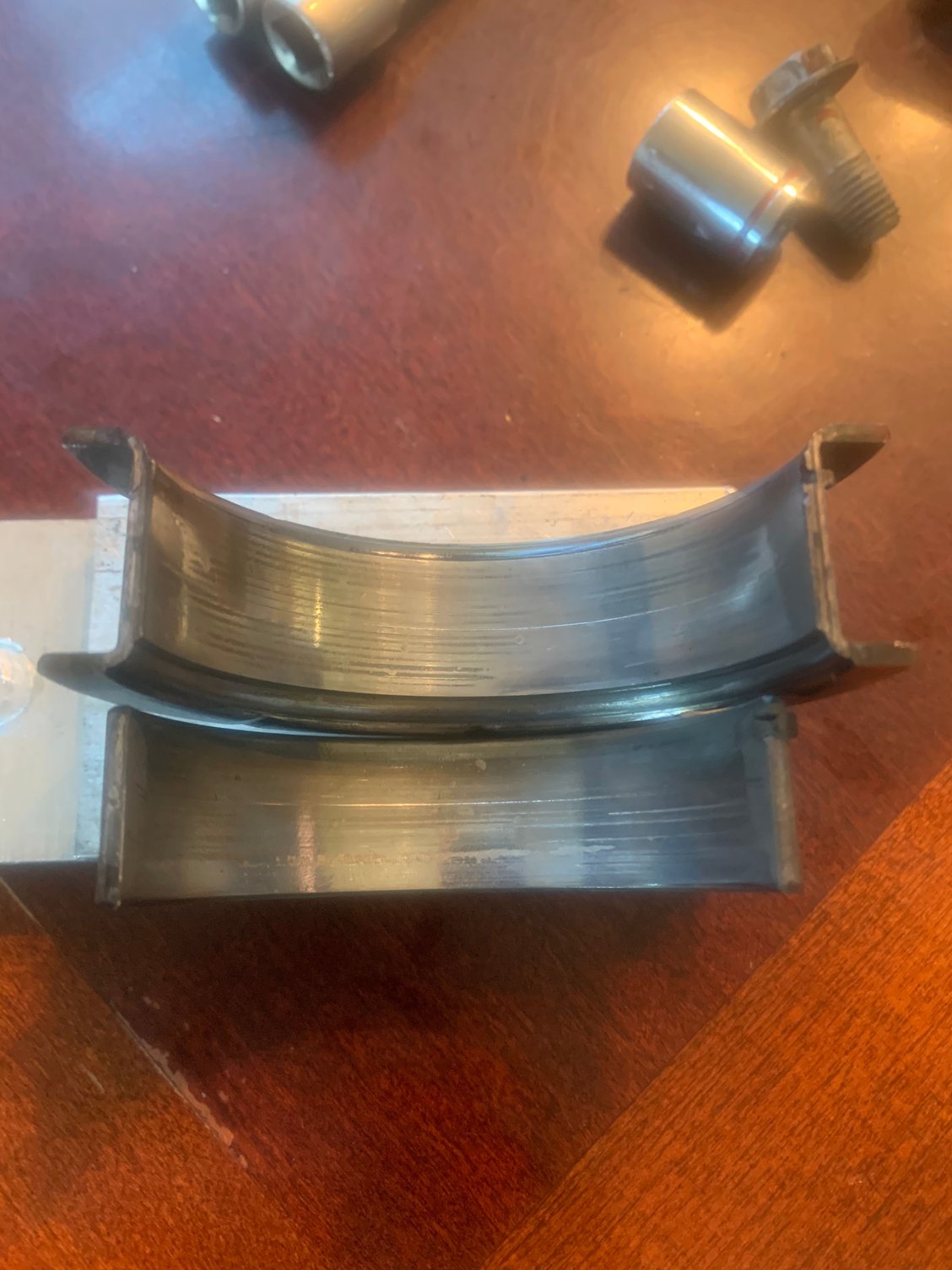

Got the tsp barbell. TSP accidentally gave me gen 3 headbolts and cam bearings for a gen 4 block. The guy i talked to at tsp said my block is a gen 3.5 which is basically a gen 4 block that was produced late in 03. My first rings to file got out of hand and ended up as a loose .032 instead of .026 so i guess i’ll replace those 2 rings. I feel like it would be fine, but my ocd wont let me leave it alone.
all of the measurements look good and its ready to slap together as soon as the right cam bearings get here.
All of the bearings that came out looked decent except for these two. Hopefully it was the source of my lowish oil pressure. Thanks to my buddy mike for holding my hand on this build and teaching me the ropes.

Yeah those two bearings have seen better days. I'm sure you know to use a good assembly lube on the bearing faces only, the backsides go in dry. Stay away from any lithium white grease inside the motor as lithium will harden and clog internal passages. Don't forget to set the thrust bearing after you get the main bolts lightly tightened. You want those thrust surfaces to be even before torquing the mains.

Them bearings don't look great but I don't think that was your oil issue. I would suspect maybe a stuck relief at the pump.
