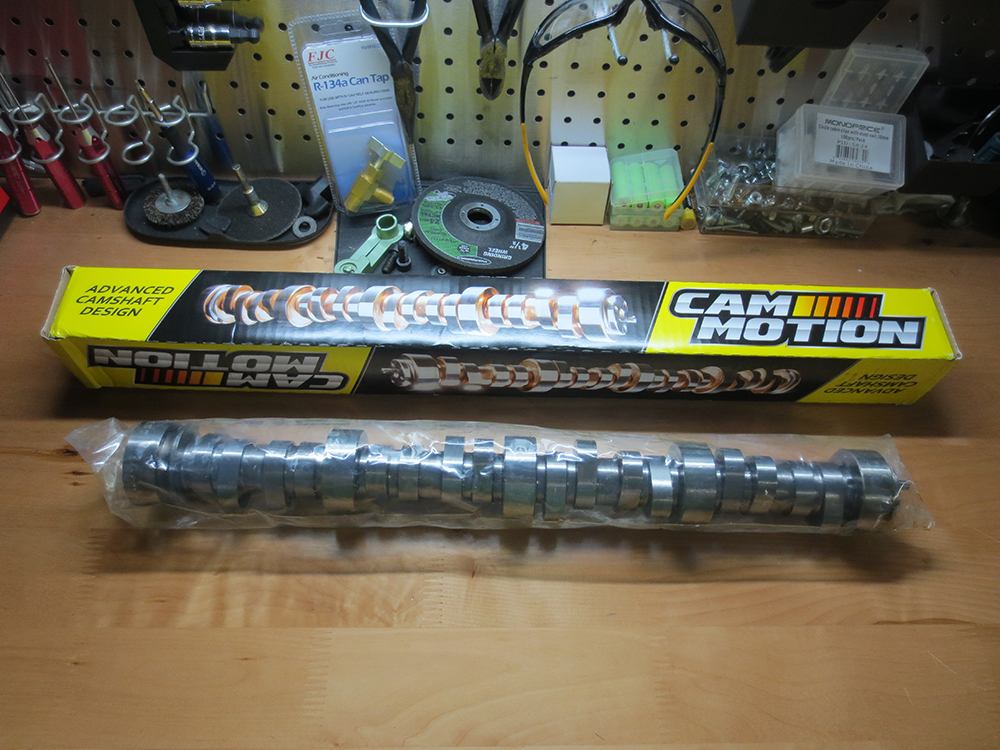

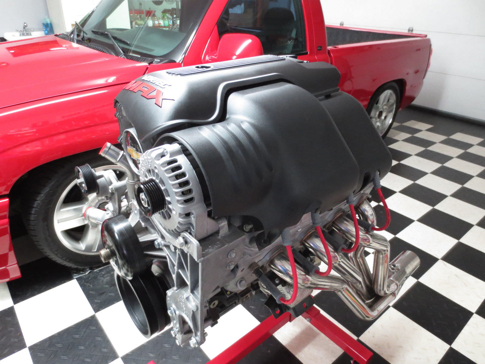

The low mileage Little Chopper camshaft and clean (bought new) Vortec Max engine covers will be in the classifieds in a few weeks so keep an eye out if interested.
