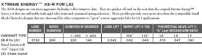

Some info about the cam's lobes...
Also, which lsa would work best: 112 / 114 / 116? I would like to shift no higher than 6700 rpms.

The 112 would have a choppier idle and probably a bit more midrange than the others. The 114 and 116 would idle smoother. I think that this cam would work well in your application, with no additional head work. I would get the 112 LSA because I like choppier idles, it would probably be a little stronger in the midrange than the others too, but the 114 would probably offer a smoother, less peaky power band. I would choose between those two and either should work just fine. Should really wake it up!

I was also thinking 112 since most guys who have the TR220 have had great success with a 112lsa. Since the duration and the lsa is the same, this cam would probably have a similar power curve as the TR220. I don't mind the cam being choppy, I use my truck for fun. I wonder how much difference the extra .030 of lift would make.
