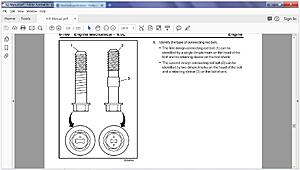

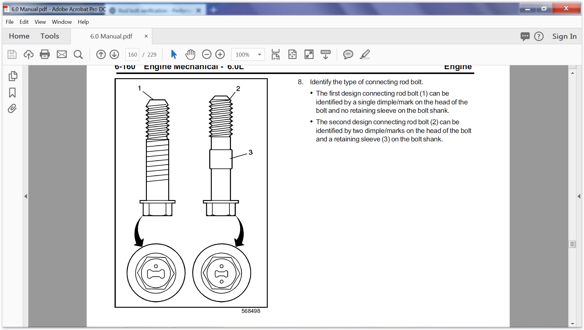

Not sure this helps but this is in the 6.0 manual

Ya I ran across that while searching. The bolts I removed are the ones on the right of that diagram. The new ones have a similar thread design as the ones on the left, but have a bushing that fits loosely in the cap. Makes no damn sense.
