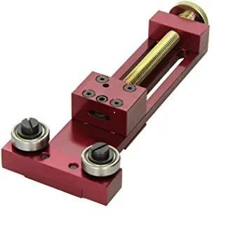

I've always wanted a filter cutter, this is the one I ordered.

Can’t really see that picture.

I swear its not usually that small
