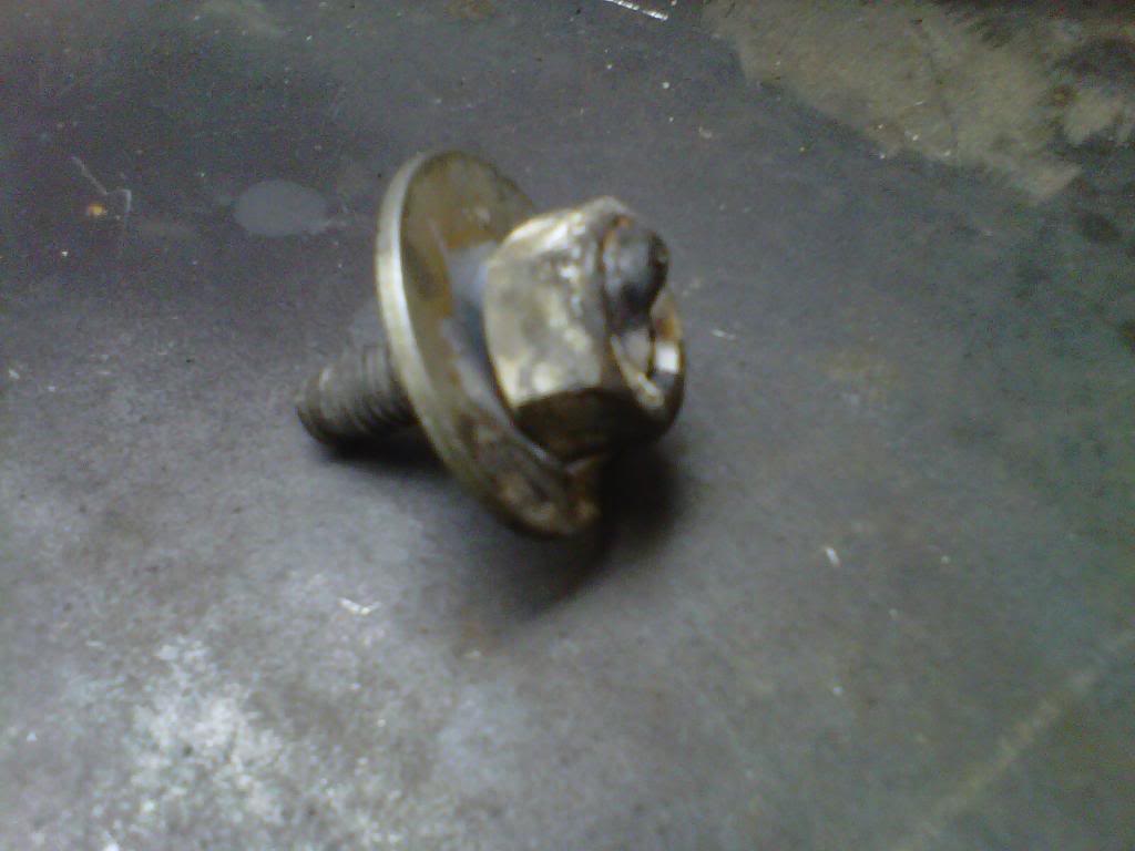

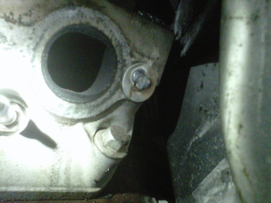

My drivers side bolt closest to the firewall was also broken, and flush with the head too. I had just enough room to get a mig torch in there and weld a washer on, and then a bolt to the washer, it wasn't pretty but it stuck well enough to turn it out. It can be done!!

Thats what gets the job done. I would try everything before I had to pull the head.
