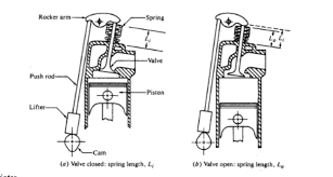

The valves won't stay up enough to remove and replace the keepers. If you are so against using compressed air, what magic is going to turn the impact gun that you speak of to remove the crank bolt? No, you have to measure the installed height, remove the springs, and take them to a machine shop that does cylinder heads.
then slide wooden doles into block to prevent the lifters from falling into cylinder.

after looking at image are you Guys saying even if piston is TDC the valve stem isn't long enough even w spring completely squished down to get keeper back in?

piston holding up valve valve drops into cylinder.
