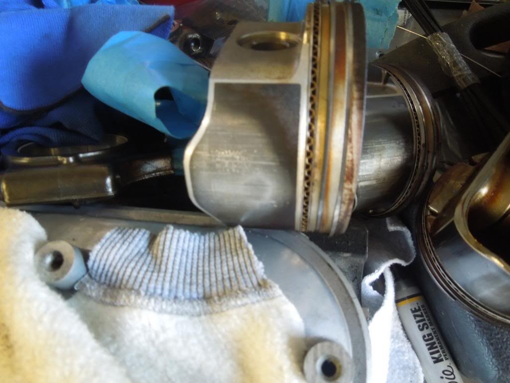

Pulled the pistons and everything looks ok. No broken lands and rings look good also. Is it normal for piston skirt to have wear scuff marks? I found a little nasty black film on pan it sparkles so think its from lifters and cam they have abnormal wear like hardening was bad. Bearings ok I guess not really sure but looks like normal wear no copper. At this point should I check the main bearings also? This is the furthest Ive been in an engine so I have read alot but no experience makes it a little tough to know what is ok. Thanks

All sounds ok. post pics of bearing and stuff.

A little wear on the skirts are normal, however I agree some that some pics would definitely help judge...

Here is a picture of the piston thats suspect, looks alittle worse than picture shows.

The one behind it looks a little worse...

Completely normal looking but I would not reuse them. New 5.3 pistons are cheap.
actually the one in the front has a spot where it has more damage almost like a small flat spot

That wear looks normal, does the cylinder wall itself have any scuffing?
No they look good except for #8 has a vertical scratch barely can get my nail to catch.

If you can feel the scratch with your fingernail, usually the rule of thumb means that it would at least need a hone.
