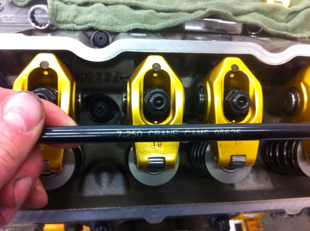

I've had to run 7.25" pushrods in a few engines. Just depends on the combo.

Originally Posted by Atomic
Have your heads been milled any?
I use 7.3" pushrods on my 402 since my heads were milled some, and there was a slight mill on the deck surface. Trust your measurements.
If I remember correctly, the heads were milled originally to achieve my stock compression(10.1:1). I figured that would just make them the same thickness as my stock 317's. That could be a wrong assumption right there. Also they were just milled .009" to make sure they were straight and true.
[QUOTE=AKlowriderZ71;5054759]I've had to run 7.25" pushrods in a few engines. Just depends on the combo.
What was the reason for making the PR had to be shorter? Milled heads?

head milling, base circle, block decking, rockers, and lifter model can all affect pushrod length. trust your measurement IMO. I may have a set of 7.250 pushrods laying around.
