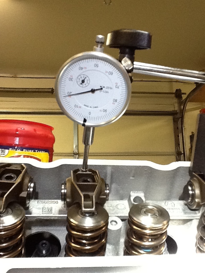

I tried the turn method and I must say I Don't trust it so instead I used a dial indicator, and what I measured with my checker tool and what the indicator said we're spot on.... The turn method was not. Just my .02

In my original post, I was referring to turns on the checker tool. Are you saying your checker and dial were exactly the same?

Yeah I thought you were referring to the torque method when you said turns... I agree you might want to see if the block had ever been decked.
