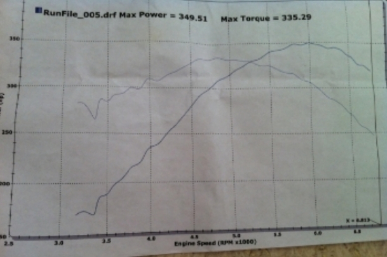

Default New motor is in
prc ls6 stage 1 heads (58cc irrc) and 228r (114lsa) on a forged 346 with -2cc diamond pistons. I built the motor for n20. I expected more power! Do these numbers seem low to anybody?

Joined: Jun 2011
Posts: 98
From: Jesup GA
My buddys camaro made the same with a stock ls1 with programmer and headers. Seems low to me just my .02

ive seen 400 rwhp cam only ls1's. I dont know what the deal is? it does have stock injectors and truck intake. Anybody else have .02 cents?

What was AFR and timing?

i dont have access to the tune file. ill have to ask my tuner.

That is low we made on a ls1 with trick flow heads and the same cam we made 440 hp

i was looking for 400 honestly. i feel like there is a fuel issue, but im no tuner so im back in this boat again. Anybody in houston willing to check over my tune?

Who tuned it?

What is the exhaust set up?

1 3/4 longtubes through 3 inch corsa sport.
