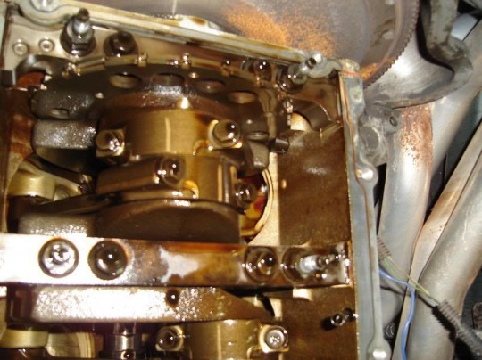

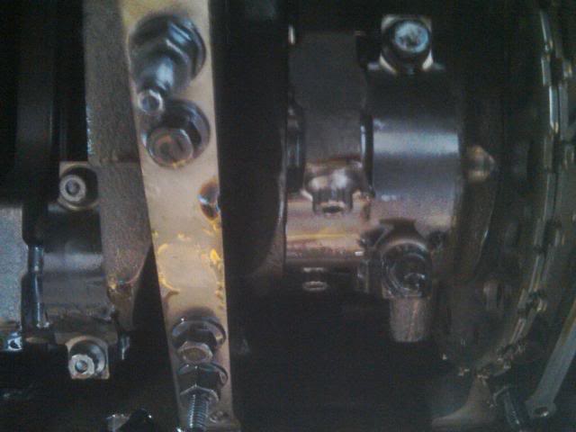

First what style of rod are do you have? 99-04 LQ4 used a press pin. 05-up LQ4 had a floating wrist pin.
1st picture Shows Press pin rod. Flat squared side of rod always faces forward.
2nd picture shows Floating pin rod. The Larger section of connecting rod always faces forward.
The Generall installed them that way for a reason... I Dont know why, but I dont want to find out the hard way... I have heard they can be flipped but again I personally followed the factory recomendation on my engine.
