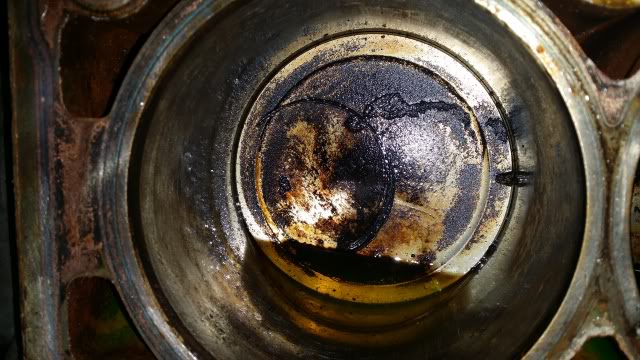

now that i could get out there with better-ish weather. i found a new problem. this is the rear piston on passenger side (number 8?). but this looks like old damage to me since it has carbon build up and my valve shows now sign of impact.

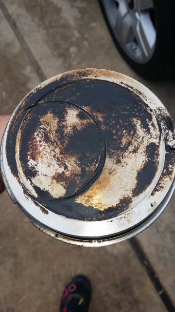

here it is out of cylinder

who wants to explain that damage, because i'm drawing a blank here lol.

Need more pictures of the piston and cylinder head, from multiple angles.
