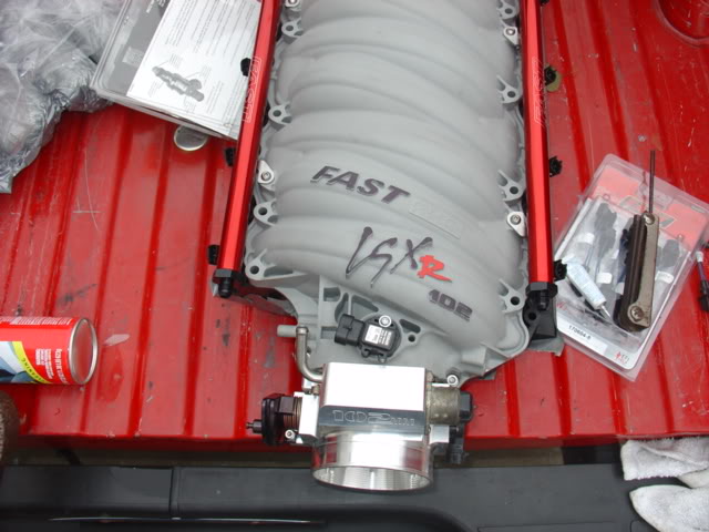

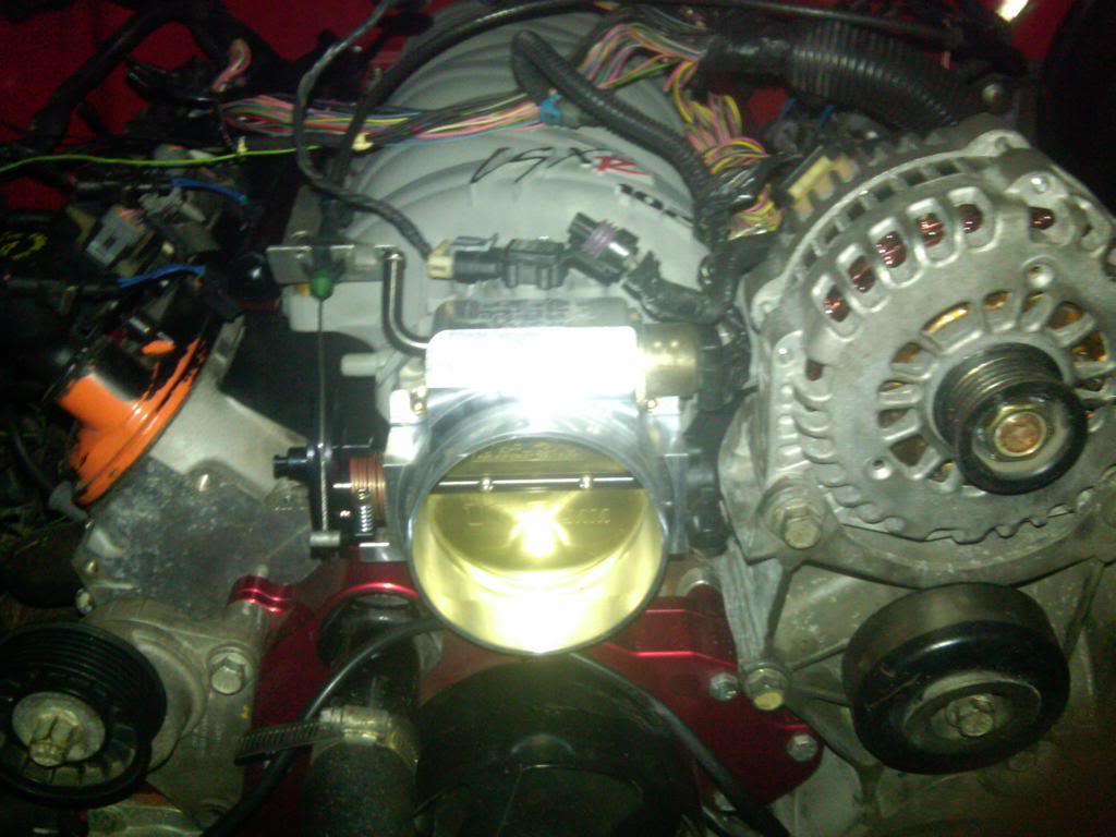

check out Skeet's setup . . .
RCSB:FULLY BOLTED LQ9 6.0,EWP, L92 heads stage 2,FAST LSXr intake,FAST #50lb Injectors,232/238 .6xx lift cam,E-fans, 160 Stat,UD pulley, FAST 102 MM TB,Tuned By Flaco,4000 Triple Disc PI stall,4l60E tranny Performabuilt, 4:10 gears, Auburn Pro Series LSD.Kooks Headers(Lt's) Full 3" Dual Exhuast to 2 Borla XR-1 Mufflers & 4 Link with QA1 adjustables sitting on Bogarts!
