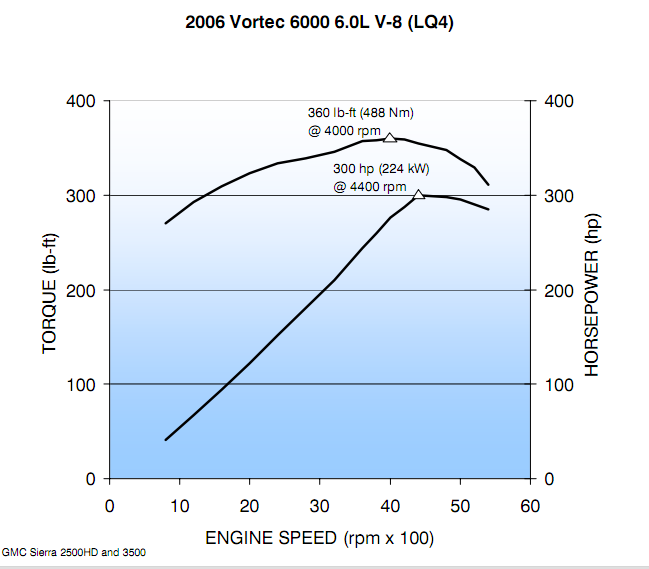

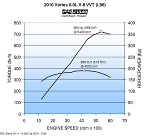

I'd take that lengthy post above with a grain of salt. That guy really exaggerated the point to try and make his hypothetical theory proven. A L92/LS3 head on a 6.2l (4.065") is fine and works great on a 6.0l (4.00") no matter the "weight".
I would second this. Look at the SAE power numbers for both engines. (disregard the different scaling)

It's only 200 rpms different from peak to peak but it feels like so much more in practice. What gives? The torque below peak looks fatter on the 2010 too.
I could be wrong, but I believe that is a function of VVT. It increases the dynamic compression on the low end.
