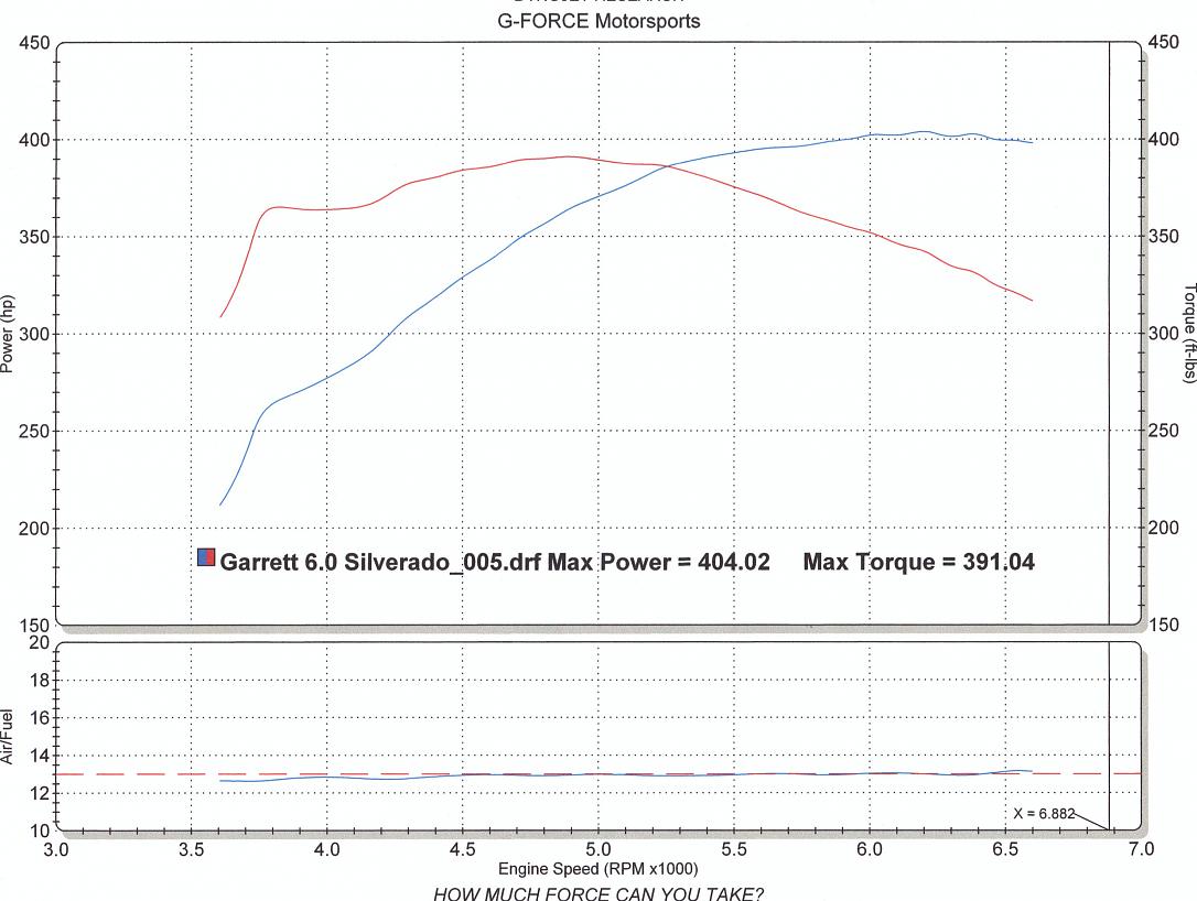

Default My 6.0 '03 rcsb dyno results
Finally got this thing able to drive. Dyno'd it last night at G-force in Pearland.
Mods: LQ9
- 230/236 .581/.581 on a 114
- TBSS intake
- Full 3" exhaust, pacesetter LT's, chambered borla xr-1
- 25% UDP
- 4" CAI
- Built 4l60e w/ vig 2800
- Custom, speed balanced aluminum driveshaft
Still running the 3.42s on a 32" tire...lol
Much thanks to my friend Inspector 12. This truck would still be in my driveway with the original 4.8 and a blown transmission if it wasn't for him. He does great work and knowledge is pretty much second to none.
And thanks to Mike at G-force for his patience and expertise. And also for the transmission fluid.

Nice numbers!

Thanks man. Forgot I about adding dual electric fans.

sweet numbers!! congrats!!

Damn 32" tire and 3.42 gears you had to be spinning that thing up on the dyno.

good numbers. im sure with that big of a cam you would benefit with a larger converter

+2 on the converter, but nice numbers either way

Very good numbers.. What gear was pulls made in? Was converter locked?

congrats. great numbers

Great numbers!!!! you make me wanna dyno mine.
