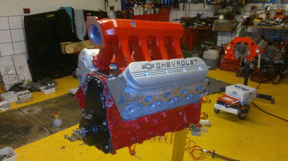

Edelbrock have them to.. For old and new style heads. Just finished my girlfriends engine. Take a look.
Using Holly 90mm TB on it.
