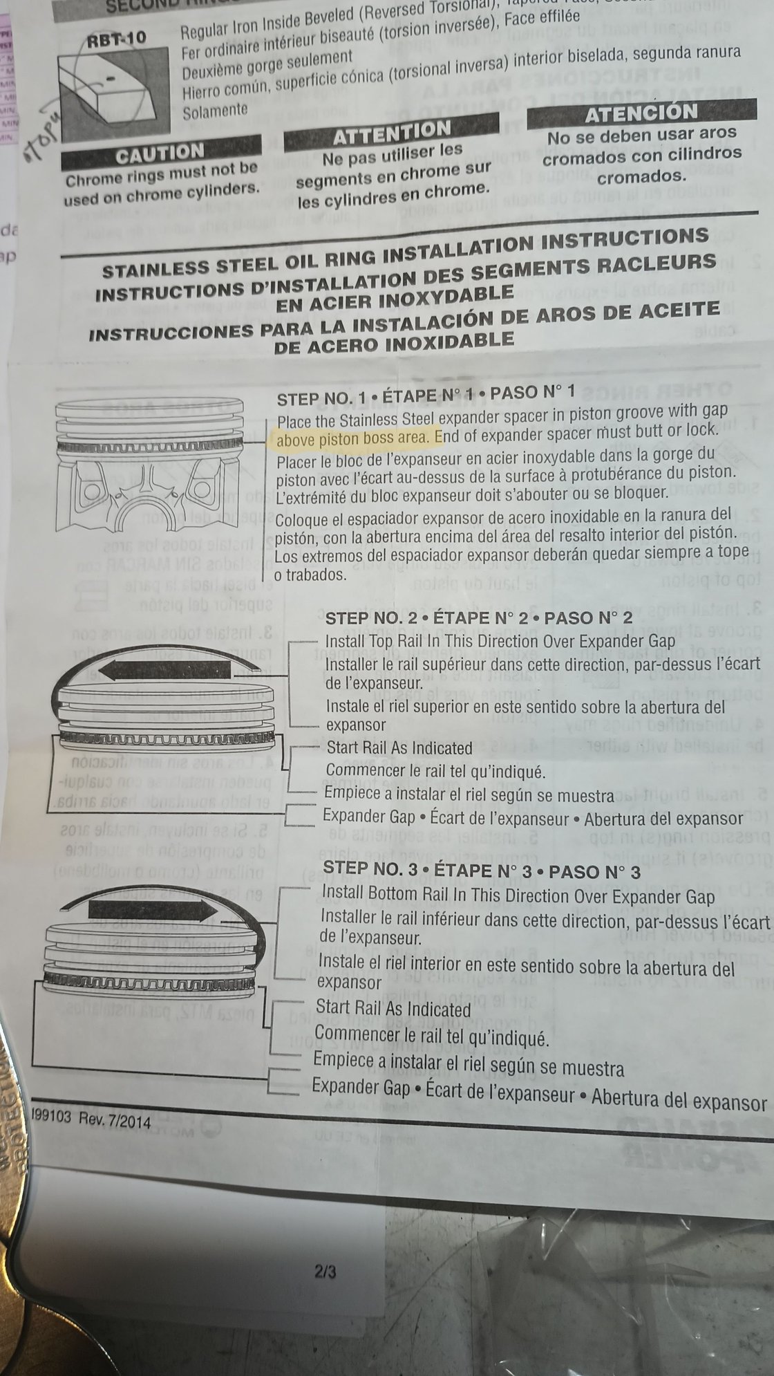

Ok, finally found the courage to file the rings. After filing a few I kinda got the hang of it.
Filed them to for a street application per the Hastings table, using 4.020" bore diameter:
0.020" for 1st compression ring
0.018" for 2nd compression ring
0.015" for oil control rings
I'm not clear on the instructions on the expander ring joint location. It says to place it above the piston boss area. Where is that on the piston? Other articles I've seen say it's the outside of the engine (3 or 9 o'clock looking down)?

Ive never read that far into the instructions.
But i always put the ring joints to the front or rear of the engine. dont forget to deburr the cut edges of the rings also.
