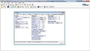

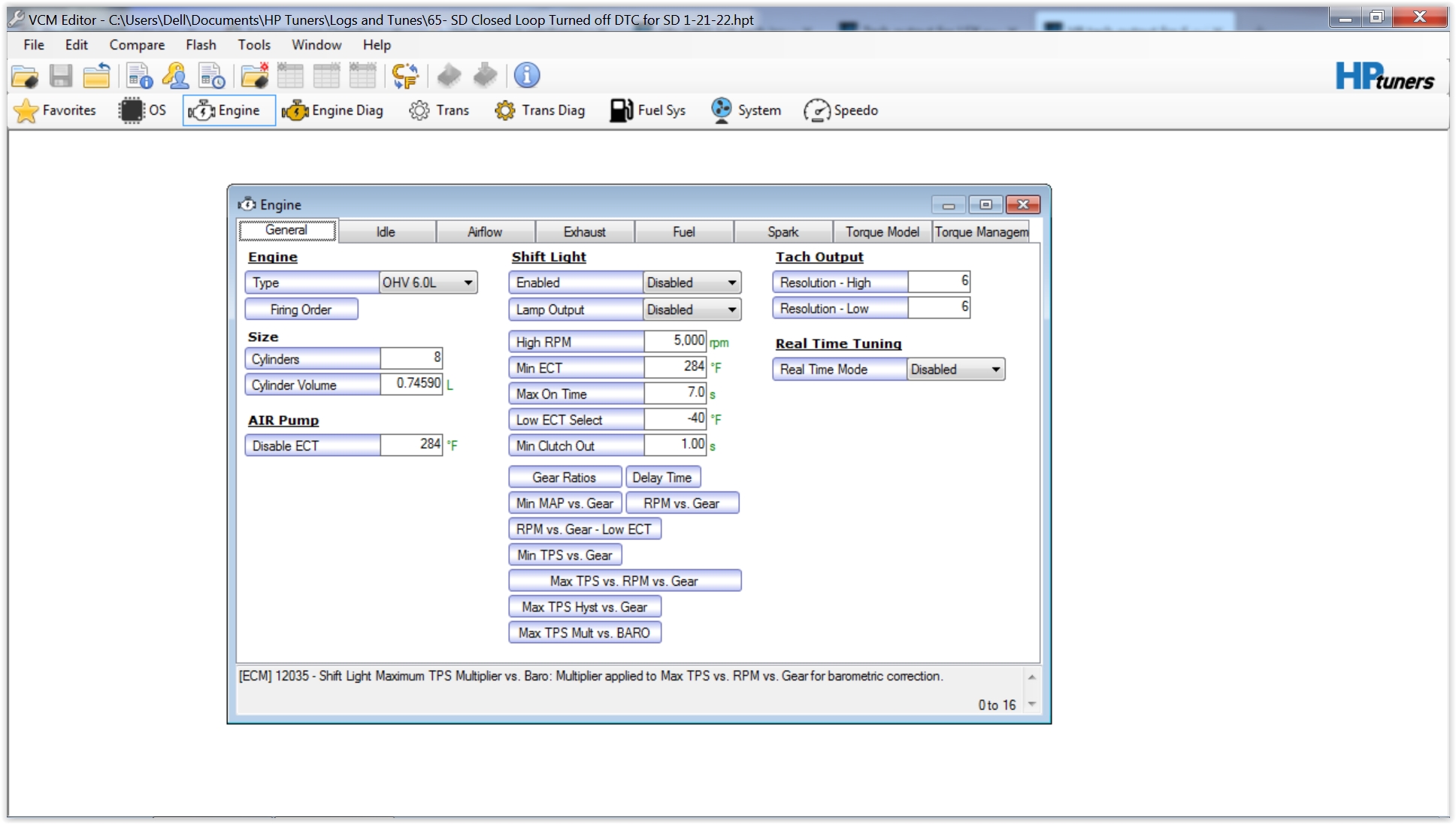

Check to see if the the Tach Output is been corrected from output "4" for the V6 to "3 or 6" for the V8 in HP Tuners
