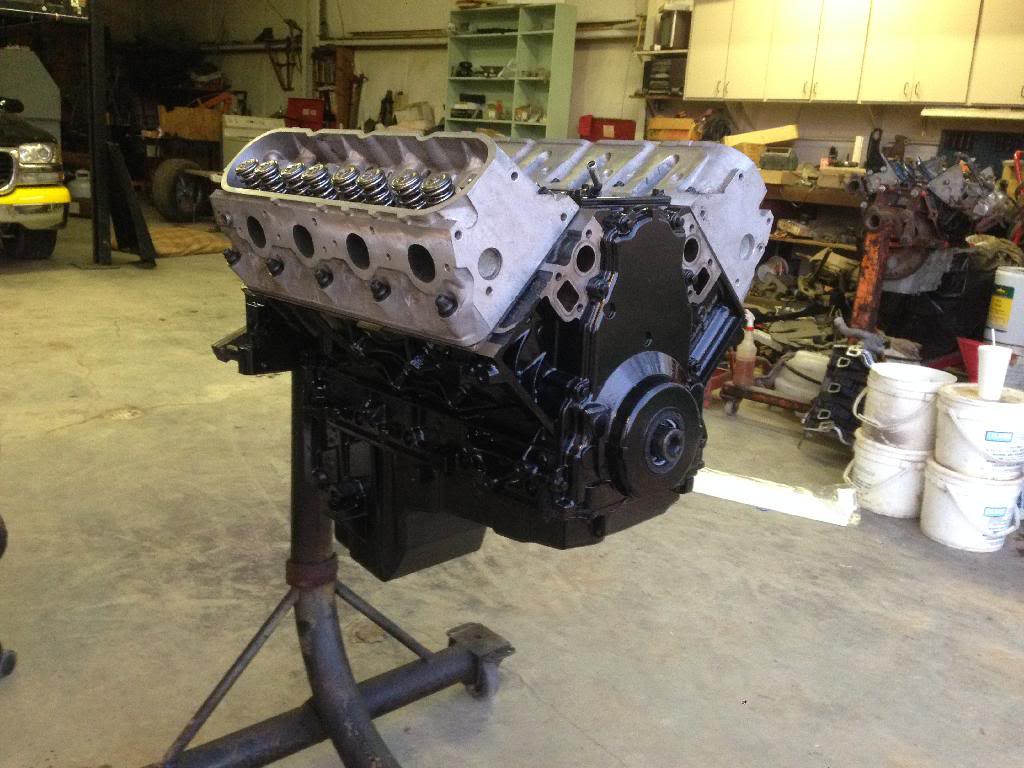

Old Apr 28, 2014 | 09:42 PM
SumtinCoo's Avatar
Joined: Dec 2011
Posts: 80
I just took a wire brush attachment on a cordless drill, dipped the brush in paint thinner and went to town on the block. Painted it with dupicolor engine enamel primer, then gloss black. Turned out pretty good but hasn't been off the stand yet so no wear and tear on it yet.
