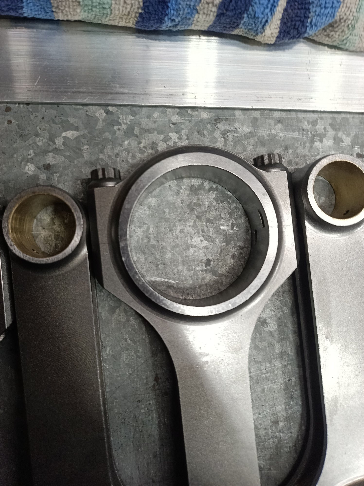

eBay rods speed racing rods
Part number RSRM97213LS
https://www.ebay.com/itm/313476718904?mkcid=16&mkevt=1&mkrid=711-127632-2357-0&ssspo=uTufAXavSfe&sssrc=4429486&ssuid=ynqlLikaRE W&var=&widget_ver=artemis&media=COPY
Forged 4340 Steel 6.125" H-Beam For LS LS1 Chevy Camaro Corvette Bushed , 7/16 Bolts
Specifications: -
Connecting Rod Length : 6.125" -
Rod Journal Diameter: 2.100" -
Wrist Pin Diameter:0.927" -
Connecting Rod Bolt :7/16" -
Connecting Rod Type: H-Beam -
Big End Width: 0.945" -
Advertised Horsepower Rating (hp): 700hp Wrist Pin Style: Floating -
Rod Material: Forged 4340 Steel -
These fit all LS style engines with aftermarket pistons with .927'' pin.
Anybody want me to measure anything before I return them?
  • They all weigh within a gram of each other. 655g
  • The big end to pin centers are correct
  • They are machined off center and the Machining is different from rod to rod.
  • Rod bolt holes are machined in different places off center on most of them.

Edited my original post and added info. Was going to put them in a turbo LQ4, but I have decided to look for something else.
