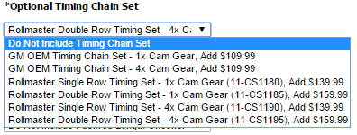

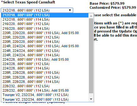

I'm going to go with Texas Speed and Performance's DoD delete kit with LS7 lifters, but I'm kind of lost on the rest of the cam swap, as far as what cam I'm able to go with, and what pushrod length will be required.

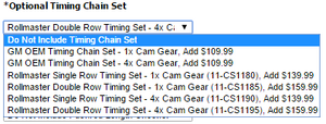

And will I need a new timing chain set?

Do you plan on doing a stall at some point? You will need the 4x cam gear if your gonna go aftermarket cam. And if your not milling 7.4s are pretty sure bet. Never hurts to measure tho. Some of these cams have different base circles
