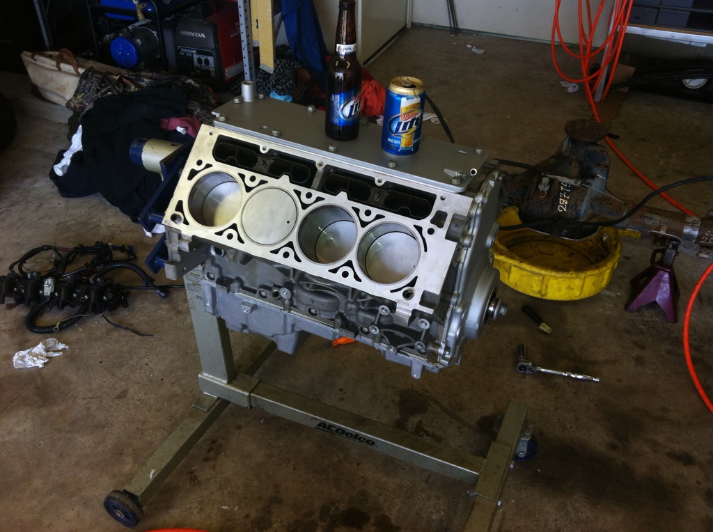

probably. i like mine spotless though. 3m rolec pad. i use the green plastic one.
before:
after:

So it appears to only be a 2 beer process to to clean both side's.
Old Jun 1, 2014 | 04:23 AM
TXsilverado's Avatar
iTrader: (19)
Joined: Jan 2005
Posts: 18,364
Likes: 291
From: Humble Texas
yes, it's a 2 beer job.
