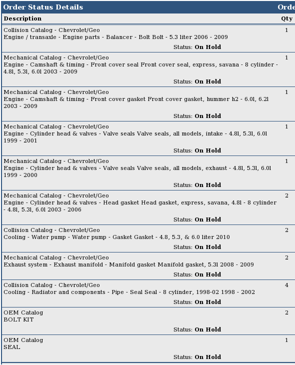

I am doing some engine work on my '01 5.3L, and placed a large order with GM last night. I found all of the parts with the part numbers, which are claimed to fit all Gen III LS motors from what I could tell. However, the site that I ordered them from says the parts fit various years from 1999 to 2010. I submitted my VIN to them also and they emailed me back pretty much wondering what the hell I was doing with all of these different parts.
Here are the part numbers I ordered, in the same order as the screen shot (the screen shot doesn't have the part numbers on it):

Here is a screen shot of the order. Thanks!

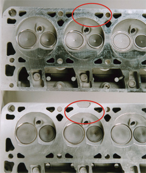

Head gaskets is a toss up deppending on when it was made. Originally that year might possibly of had fiber type head gaskets instead of MLS but MLS should work unless you have real early 862 heads. Picture attached will show the issue with the early heads wich require a fiber type head gasket.#12457116 -4.8L/5.3L GM Graphite Head Gasket
