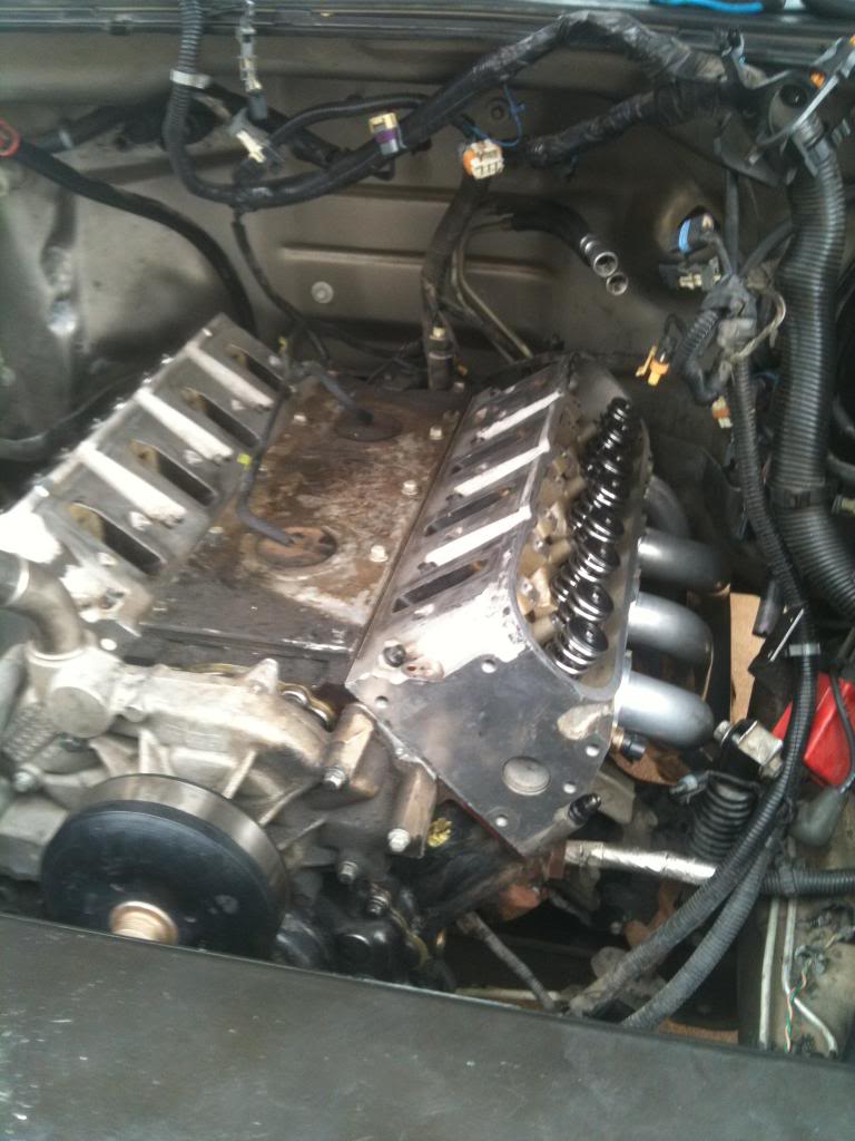

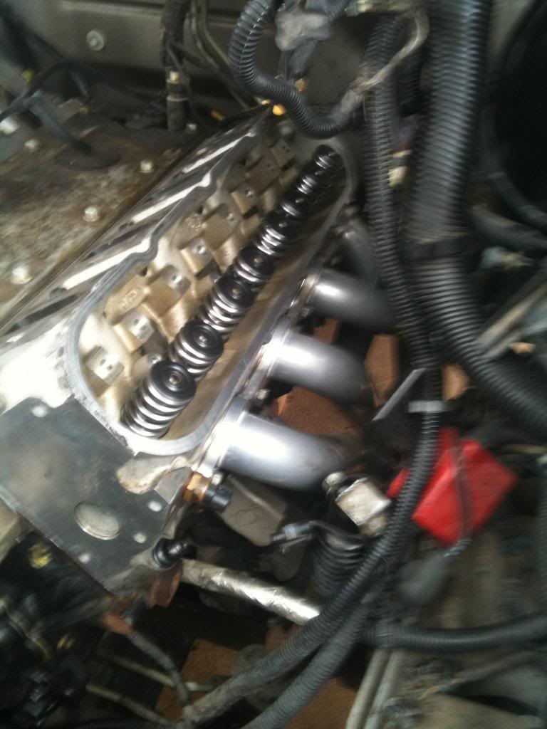

Old Apr 12, 2014 | 10:03 AM
BigEd_72455's Avatar
Joined: Mar 2013
Posts: 1,468
From: Arkansas
Those are some PRETTY heads, too bad that lifter cover and the front of the motor are all greased up!! Kind of takes away from the effort there.....
Did you know that a CLEAN engine can run as much as 10-15 degrees cooler during normal operation than a dirty one?
I agree! Unfortunately I was on a time crunch, but taking the intake manifold isn't to big of a deal and I'll probably get around to it . Didn't know it could make that much difference interesting.
