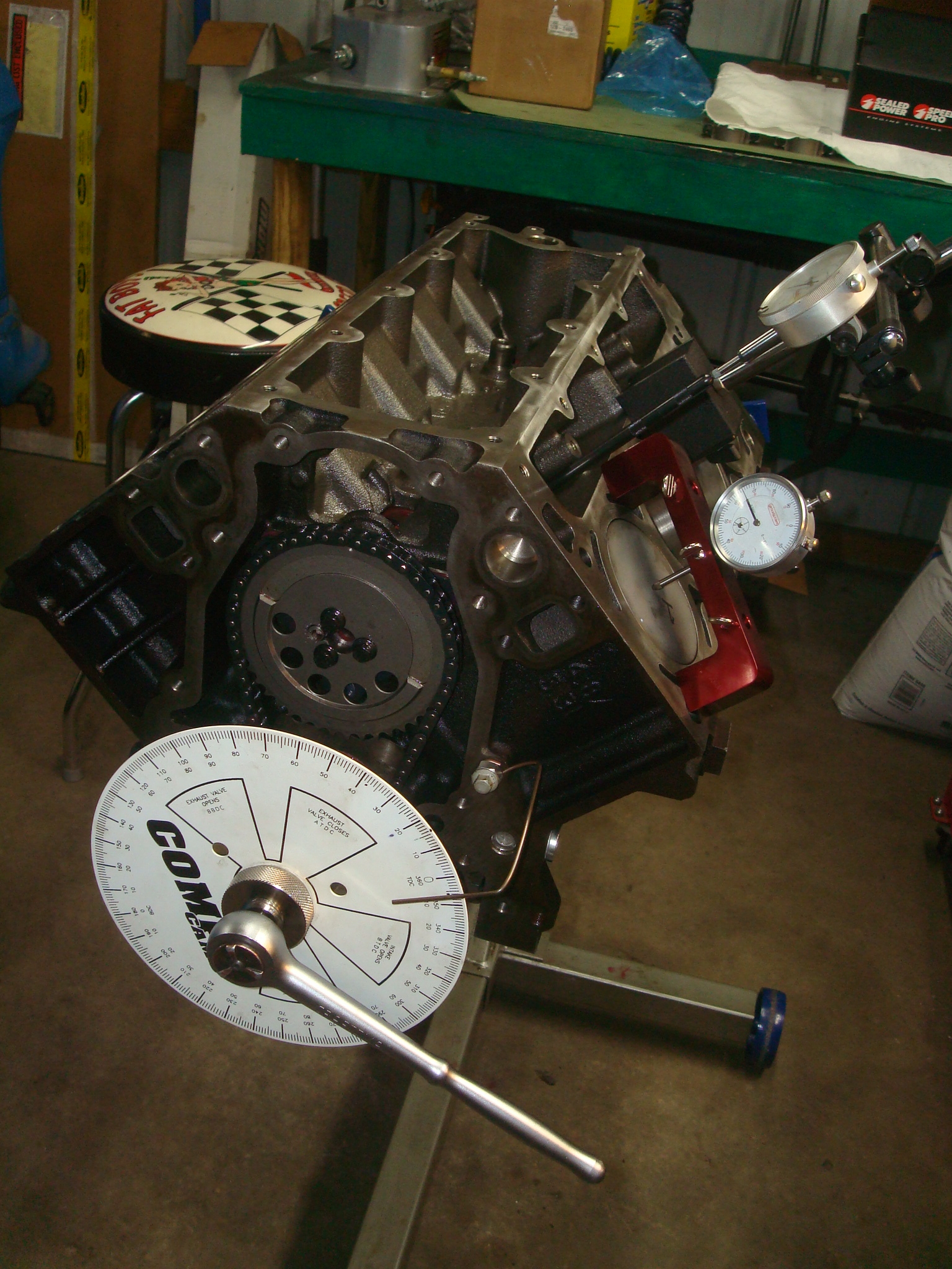

The Cam Motion cam degreed dead nuts at 111.2 ICL, right on the cam card.
What retainers and locks should I use with PAC1211X single beehive springs?
I've got .0015" skirt to wall clearance on all but #5. It had some pitting in the cylinder so the shop honed it a bit more. I'm measuring .0025"-.00275" on that cylinder. Will that cause slap with the speedpro coated hyper pistons?

Something in my gut just didnt like the endplay. I put the dial indicator on the crank and got .0015". I removed the #3 cap, left the other mains tight and got .005"! The bearing also had a shiny spot like it was cocked just a hair. WTF, over?
I sanded the rear thrust face of the lower shell on a piece of glass. I put it back together, tonked the crank back and forth and now I have .0035". The slight tight spot when turning the crank is now gone. Here's a pic of the cam degreeing.
Trust your gut people.
