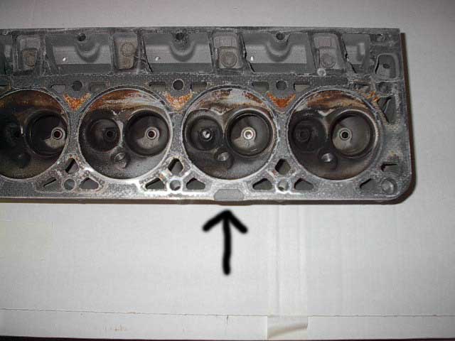

MLS gaskets are fine but you need one from a 5.7L due to the slightly larger combustion chamber. The only time a Graphite gasket is required on these engines is when the head has notch in the deck surface. See attached image.
GM built an L33 5.3L engine that uses the flat top 4.8L pistons with a 799/243 head. It used this head gasket part number 12589226. I believe you can buy a pair of the same head gaskets under 12498544
