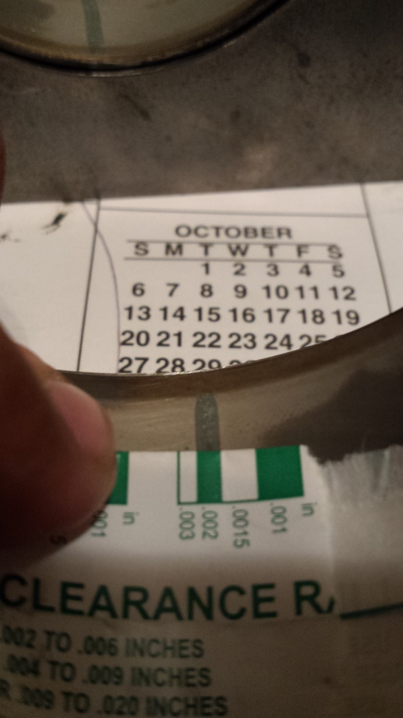

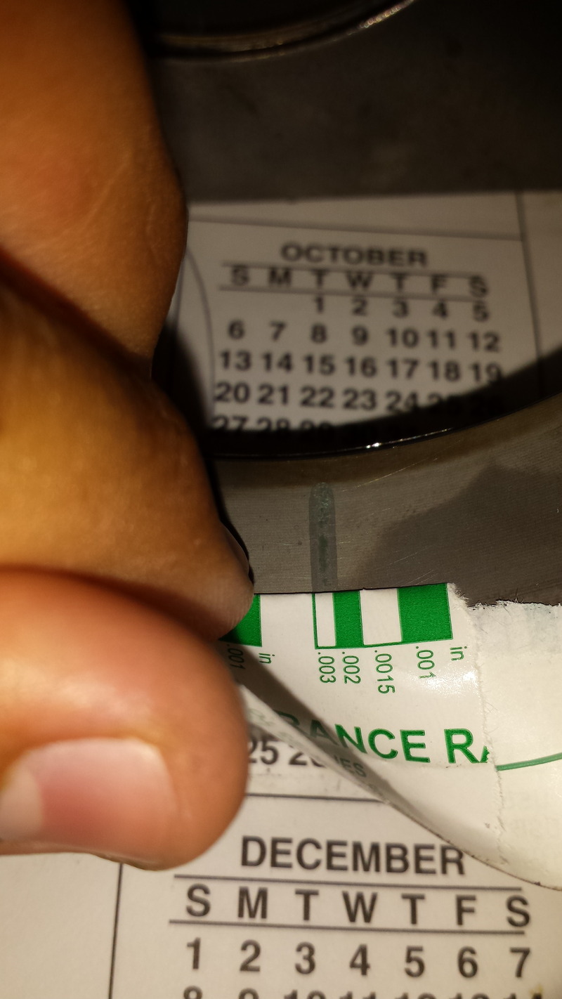

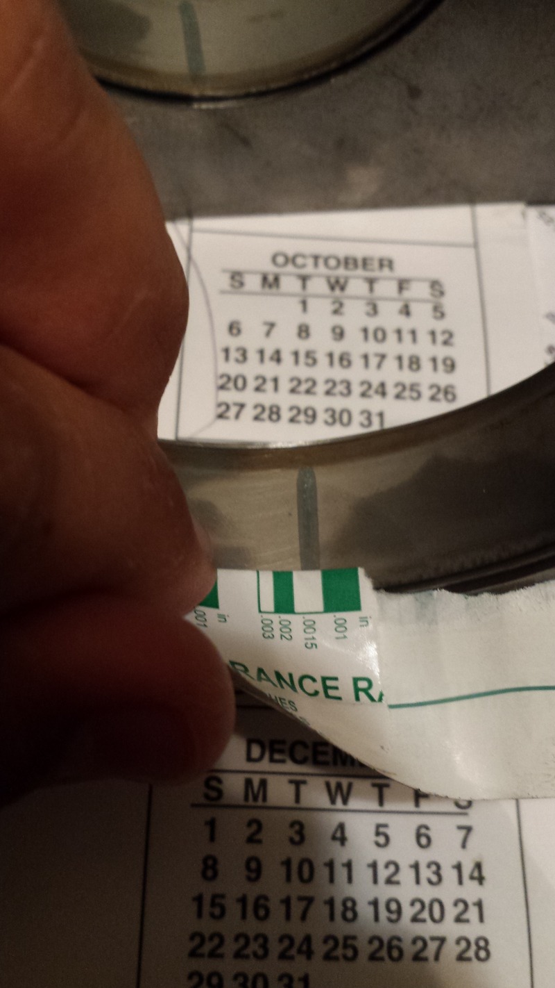

well I just finished checking main bearing clearance (plasti gauge) and I believe I'm right where I need to be! The crushed piece just about lines up with the .002 inch mark and is slightly bigger than the .003 inch ill post a pic tomorrow

I checked my rod bearing clearance today and it read .015 " I was told .025" was ideal. So now what would I do to achieve that if I'm getting .015" with standard size bearings? Or is .015 plasti Gauge reading acceptable? I'm hoping to make atleast 1000 hp thru a turbo

CB663HXN i brought some of these they have a thinner wall allowing for .001" more clearance so that should put me where i need to be!

yeah that should put u right in the ball park. it looks to me like around .025 on mains and rods. that should be perfect for what your trying to do. Good Luck!
