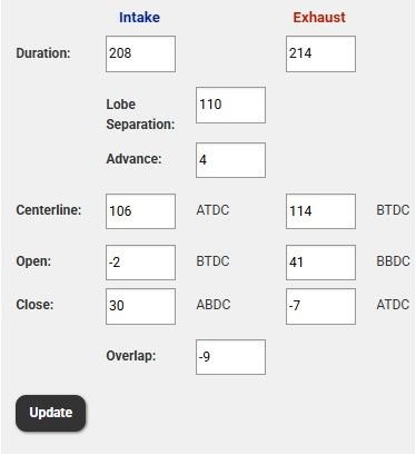

Thanks for the kind words and advice. I made the first order over the weekend. Felpro gasket set, ls2 chain, stock volume oil pump. And a few other things. Also over the weekend water tested the chambers/valves and disassembled the heads. Also scraped and scrubbed the living daylights out of them. The old cam is out.
I came across another cam I like, it's on a tighter LSA. Now have to decide which one I'm going to run.
Summit cam
209/217
.550"/.550"
112+1
Cam motion cam
208/214
.553"/.553"
110+4
Got to decide which cam. And pick up the rest of the parts. Springs, lifters, pushrods.
Soon hope to be putting it back together...

Is there any chance you could post the cam card numbers for both cams? And while it is much different than why most people nowadays would want to hear a cam idle, I'm interested in listening to each of them to hear how they idle. Stock idle speed in my truck with stock cam is too slow to make enough juice out of my 200A alternator, with all of this running: headlights, both wipers, both flexalite fans, both blower motors, & radio. The idle is already touched up a bit from stock in my tune. So any idea I can get of what the idle quality is of both cams seems helpful. I know they're both small cams and aren't going to sit there and chop away like crazy, but I may not pick the choppier of the two if it means I'll have to turn the idle up more to smooth it out to behave itself and run my electrical demands on full load.
These may be trivial things, but they're considerations I'm making before I do this.
I found one video of the cam motion cam, know nothing about the engine/combo.
And one video of the summit cam, but I know this isn't a "stock" truck gen III 5.3L.
Do you know of any videos of these cams running?

Thanks for getting back with us and that's a sweet rig! We appreciate that you want to dive in to truly understand what these options would be like for you. We hear ya on the idle. Our cam calculator will help to illustrate this. Basically, the idle quality comes from the intake valve opening (IVO). The earlier you open the intake the choppier the idle at the expense of idle vacuum.
Titan 1 LS truck 210/218 110+4
Summit 8719R1 209/217, 112+1
As shown in the calculator, the Titan 1 opens the intake valve 4° earlier than the 8719R1 and has slightly more overlap, which contributes to a choppier idle. While neither cam is designed purely for "chop," the Titan 1 should produce a slightly rougher idle compared to the 8719R1 based on its specs.
That said, no two engines are exactly alike—idle quality is influenced by factors like displacement, compression, and exhaust setup. If both cams were installed in the same engine, we’d expect the Titan 1 to require about 200 RPM higher idle speed than the 8719R1 for optimal performance.
Our 8728R1 would have slightly more of an uneven idle than the Titan 1. Here are the calculator specs for it.
If you want to dive deeper into how valve events affect engine performance, here's a great video that illustrates the concepts along with a walkthrough of our cam calculator.
We love talking cams, especially when it comes to valve timing events—they’re what truly define a cam’s performance. These events dictate key parameters like duration, lobe separation, and overlap, shaping how the cam behaves. Our goal isn’t just to sell a cam, but to help buyers make informed decisions!

I was looking for the cam cards so I could see the seat to seat duration for the Cam Motion cam, so I could compare DCR values along with the info you posted. The DCR calculator I use works a little differently than most; uses formulas to figure a dynamic stroke length based on valve events and engine specs before it spits out a DCR value. Searching helped me see where someone claimed Cam Motion told them to generally add 54° to the @ 0.050" duration numbers for the seat to seat numbers. That gives the Titan 1 LS truck cam 262/268 seat to seat duration. I've always understood LS engines to be way different than old school SBC's. According to what we're discussing here ("256" or "260" torque cams on 110 and 112 LSA's) they're not much different at all, they just make more power because they pump air better. Anyways, on to the DCR calculator numbers...
The calculator gave these DCR's:
Cam Motion - 9.02:1 (overlap 45°)
Summit - 8.84:1 ((overlap 41.5°)
From the earlier IVO, the Cam Motion grind has a little longer dynamic stroke than the 8719R1, and you wouldn't think it with the longer overlap of the Cam Motion grind, but with a 9:1 DCR, it probably fills the cylinder more (more BANG), and runs a little higher cylinder pressure too.
I haven't picked a cam yet...still thinking about it. What can you say about the core that the 8719R1 is ground from?
