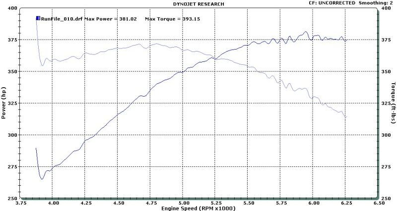

Been close to it.
Attached Thumbnails 5.3 n/a-got-400.jpg

What did it take to get there?
