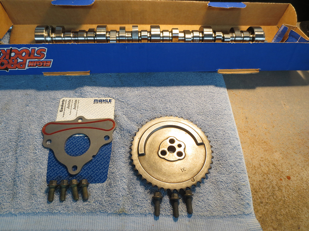

Another place to look at for poor oil pressure is the camshaft retainer plate. When doing a camshaft swap some mechanics will reuse the old plate. If that orange gasket has been mashed flat it will dump the oil pressure from the oil galleys past that seal into the front cover resulting in poor oil pressure. I always replace that $20 dollar part doing a cam swap just for piece of mind. Not saying that's your issue... but you did replace that retainer plate didn't you?

Didn't know that could cause that, but yes this was replaced. I didn't reuse anything with a gasket, o-ring, or seal due to the mileage it had when I was doing the work. Except for the TB, I guess. Mechanic I took it to also checked over everything under the front cover and didn't notice anything amiss.

That orange gasket dose not come in the gasket kit and it's not replaceable... you have to replace the retainer plate itself.
You can't see anything "amiss" without removing that plate and running your finger over the gasket to see if the gasket still protrudes enough to make the seal.
Correct
Alright, when/if I tear it back down I will take another look at it to make sure it was sealing. The front cover will be the first thing to come off so Ill double check

Good to know you didn't overlook that important step
Most "mechanics" don't even inspect the plate they just slap it back on without knowing the consequences that small overlook can cause.

I didn't actually know it could cause an oil pressure issue, so learned something there, to me its just another 'seal' that Ive always swapped. Hell, as bad as everything looked that came off of this engine i was stoked to replace anything I could. Appreciate the input!
